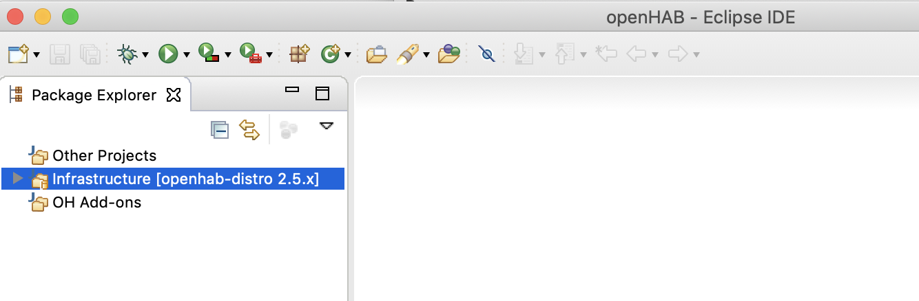

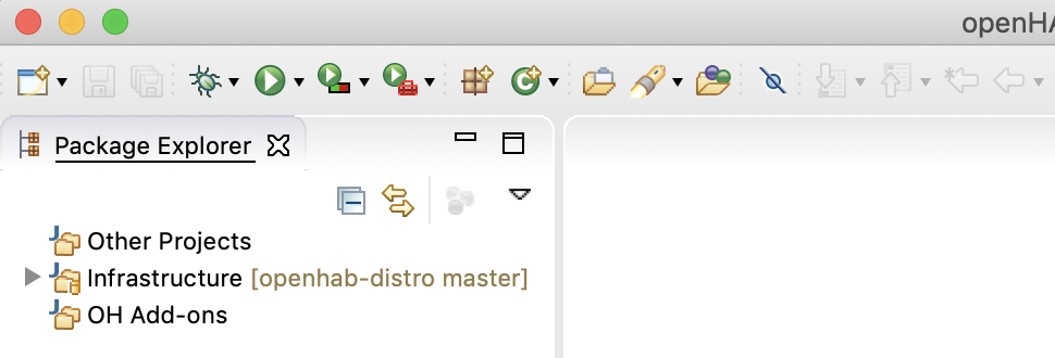

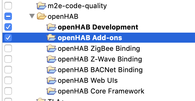

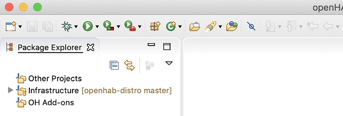

I tried to setup a fresh 2.5.x install based on the lastest repo. I selected OH Dev and Addons in the istaller, the setup tasks are performed without errors, but the result shows no OH Addons projects.

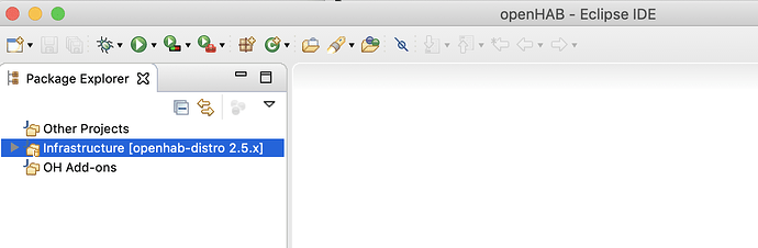

even after switching to branch 2.5.x the addon tree was not initialized
Is there anything changed in the setup process? Any action required in addition?
I tried this on. 2 machines with same result.
