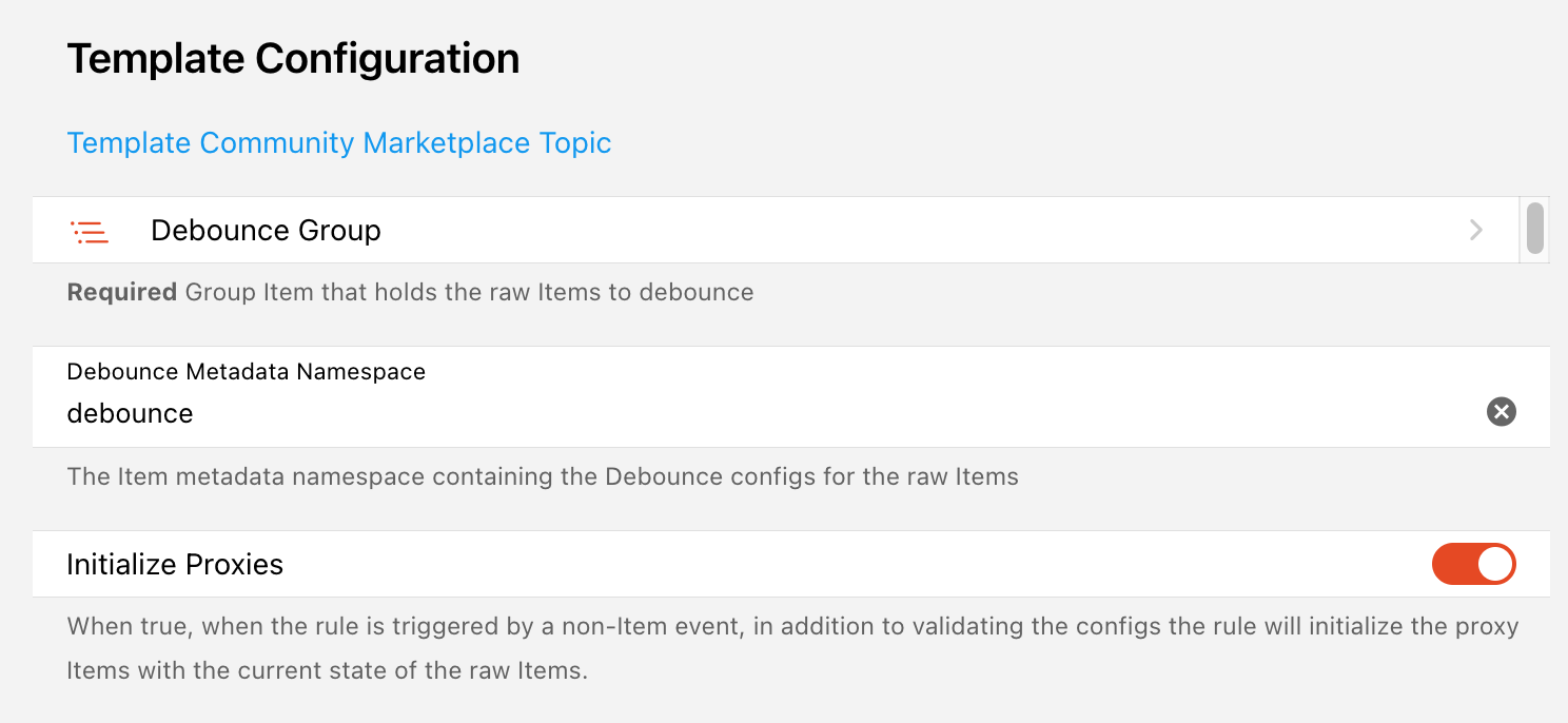

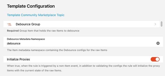

What about rule templates?
There’s a nice sunrise simulation template to control lights among others which would and if given some ideas I can quickly code up some more simple ones. The one’s I’ve written so far tend to be complicated and generic and probably don’t make a good “first look” at rules but I can quickly create some more and even use Blockly (I think) so once instantiated the end users can see how they are built.
I just need ideas on what to create which would be appropriate for a first time user.
It might be a nicer intro to rules to be able to install and then see how they work than to throw them feet first into writing from scratch. Though they will need to have some Items defined before that point.
I’m just getting my feet wet with Blockly, and found some of the rule templates to be overwhelming. It’s not that I don’t understand them–it’s just a lot to process visually all at once.

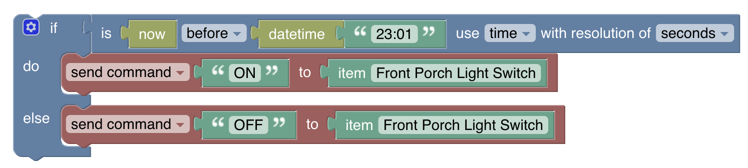

Or if we want to have some blockly involved combine the two into one:
configuration: {}
triggers:
  - id: "1"
    configuration:
      thingUID: astro:sun:local
      event: START
      channelUID: astro:sun:local:astroDusk#event
    type: core.ChannelEventTrigger
  - id: "2"
    configuration:
      time: 23:00
    type: timer.TimeOfDayTrigger
conditions: []
actions:
  - inputs: {}
    configuration:
      blockSource: <xml xmlns="https://developers.google.com/blockly/xml"><block type="controls_if" id="3bp[qw/{m,Rsbex1V~md" x="139" y="117"><mutation else="1"></mutation><value name="IF0"><block type="oh_zdt_compare" id="F~h[,td/kaN)$wd4KbuG"><field name="operation">before</field><field name="dateComparison">time</field><field name="precision">seconds</field><value name="zdtOne"><shadow type="oh_zdt" id="^VH~6bGwM-mpgL_e8uRZ"><field name="day">2024-02-22</field></shadow><block type="oh_zdt_now" id="]d|p2g~Gz^%PgID}tZ~0"></block></value><value name="zdtTwo"><shadow type="oh_zdt" id="Xl8K=wia.q:*U0xLZIgA"><field name="day">2024-02-22</field></shadow><block type="oh_zdt_fromText" id="F/3AZDDZ/-ISY.[FSf@9"><value name="day"><shadow type="text" id="(Kyt,C9PmeAUsX`nH;Hf"><field name="TEXT">2024-02-22</field></shadow><block type="text" id="^0P2`r8$|L{Fm]7R6g-Z"><field name="TEXT">23:01</field></block></value></block></value></block></value><statement name="DO0"><block type="oh_event" id="/jQuOyN4I6JUzFP]9CiB"><field name="eventType">sendCommand</field><value name="value"><shadow type="text" id="AxIc(+~PG|i*Y$DZy$K*"><field name="TEXT">value</field></shadow><block type="text" id="-P[E%.Be-tG)XR(=C,Mi"><field name="TEXT">ON</field></block></value><value name="itemName"><shadow type="oh_item" id=")5YgIY_^jwndUnvwSW|J"><mutation itemName="MyItem" itemLabel="MyItem"></mutation><field name="itemName">MyItem</field></shadow><block type="oh_item" id="sA_8`hv3ME++|m|5*2%/"><mutation itemName="FrontPorchLight" itemLabel="Front Porch Light Switch"></mutation><field name="itemName">Front Porch Light Switch</field></block></value></block></statement><statement name="ELSE"><block type="oh_event" id="Dyi0=8vs{6-d`MJ9!p8["><field name="eventType">sendCommand</field><value name="value"><shadow type="text" id="AxIc(+~PG|i*Y$DZy$K*"><field name="TEXT">value</field></shadow><block type="text" id="cR$5aK@ux@Kfwa3YJ:o]"><field name="TEXT">OFF</field></block></value><value name="itemName"><shadow type="oh_item" id=")5YgIY_^jwndUnvwSW|J"><mutation itemName="MyItem" itemLabel="MyItem"></mutation><field name="itemName">MyItem</field></shadow><block type="oh_item" id="B[}IaV1Lk}BRgsHjD85F"><mutation itemName="FrontPorchLight" itemLabel="Front Porch Light Switch"></mutation><field name="itemName">Front Porch Light Switch</field></block></value></block></statement></block></xml>
      type: application/javascript
      script: >
        // graalVM
        function zdtCompare(zdt1, zdt2, compareOp, precision, compDate) {
          switch (precision) {
            case 'years':
             zdt2 = zdt2.withMonth(zdt1.monthValue());
            case 'months':
             zdt2 = zdt2.withDayOfMonth(zdt1.dayOfMonth());
            case 'days':
             zdt2 = zdt2.withHour(zdt1.hour());
            case 'hours':
             zdt2 = zdt2.withMinute(zdt1.minute());
            case 'minutes':
             zdt2 = zdt2.withSecond(zdt1.second());
            case 'seconds':
             zdt2 = zdt2.withNano(zdt1.nano());
          if (compDate === 'date') {
            zdt1 = zdt1.toLocalDate();
            zdt2 = zdt2.toLocalDate();
          } else if (compDate === 'time') {
            zdt1 = zdt1.toLocalTime();
            zdt2 = zdt2.toLocalTime();
          switch (compareOp) {
            case 'before':
              return zdt1.isBefore(zdt2);
            case 'equal':
              return zdt1.equals(zdt2);
            case 'after':
              return zdt1.isAfter(zdt2);
            case 'beforeEqual':
              return zdt1.isBefore(zdt2) || zdt1.equals(zdt2);
            case 'afterEqual':
              return zdt1.isAfter(zdt2) || zdt1.equals(zdt2);
        if (zdtCompare((time.ZonedDateTime.now()), (time.toZDT('23:01')), 'before', 'seconds', 'time')) {
          items.getItem('FrontPorchLight').sendCommand('ON');
        } else {
          items.getItem('FrontPorchLight').sendCommand('OFF');
    type: script.ScriptAction
Blockly:
Either can be made into a rule template. However, rule templates cannot change the rule’s trigger through a parameter so the trigger at 23:00 can’t be a parameter.
