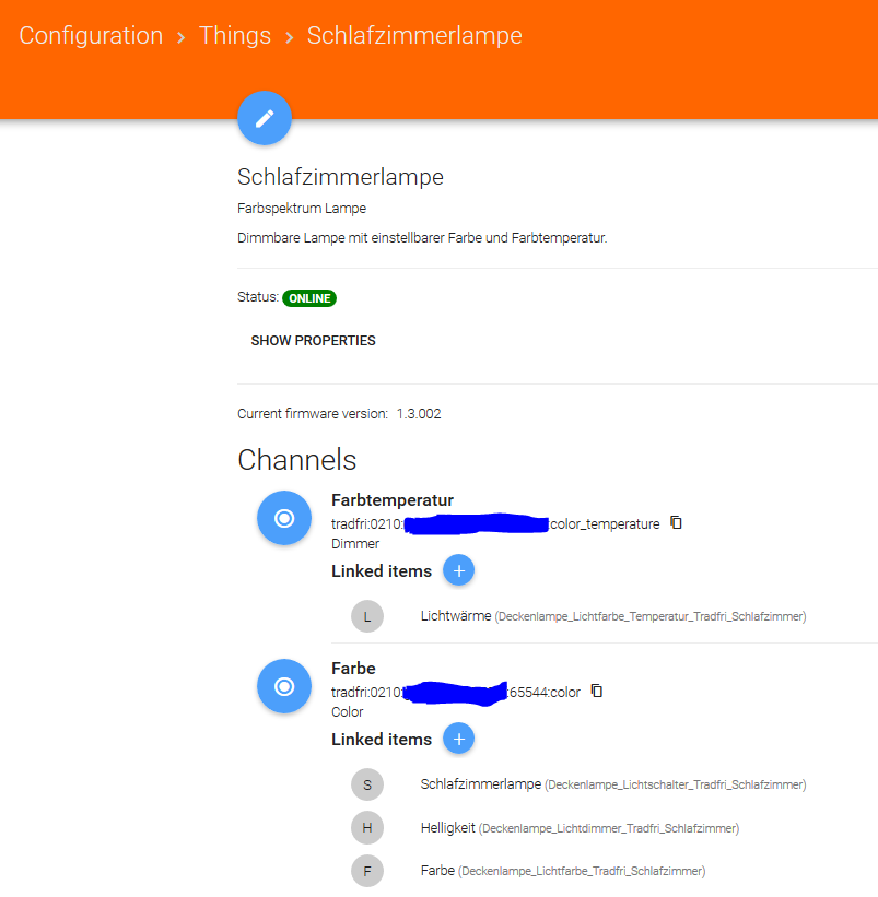

the color channel of our ikea color bulb was recognized automatically after an upgrade from oh 2.1.0 stable to 2.2.0 snapshot:
grafik

as you can hopefully see in the screenshot above our bulb is on the same firmware level.
