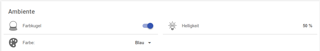

Here my complete Work A Round
Item
Number colorpicker_wohnzimmer_schrank "Colorpicker Wohnzimmer Schrank"
Sitemap
Selection item=colorpicker_wohnzimmer_schrank label="Farbe:" icon="colorpicker" visibility=[Stehlampe_Wohnzimmer_Schrank_Switch==ON] mappings=[
            0="  Warmes Licht  ",
            1="  Tageslicht  ",
            2="  Nachtlicht  ",
            3="  Sonnenuntergang  ",
            4="  Gelb  ",
            5="  Helles Gelb  ",
            6="  Helles Grün  ",
            7="  Orange  ",
            8="  Helles Orange  ",
            9="  Rot  ",
            10="  Pink  ",
            11="  Helles Lila  ",
            12="  Blau  "

I’m not sure, why you have modified the bash script. But don’t replace the params $1, $2 and $3 with a static content. Otherwise you could use the script only once for one bulb and executing with 3 Schl_Bambus_bu_brightness"+ Schl_Bambus_bu_Color.state doesn’t make any sense
According to your example, I have the following suggestions:
items file should look like this … it makes actually no sense to implement the other channels for a colored tradfri bulb at the moment, because they don’t work (as expected).
Number Schl_Bambus_bu_brightness   "Helligkeit [%.0f %%]" <bulb>
Number Schl_Bambus_bu_colorpicker  "Farbwahl"
Color Schl_Bambus_bu_color         "Farbwahl" { channel="hue:0200:00178821c409:6:color" }
rules files should look like this
// RGB Workaround Schlafzimmer Kugel
rule "RGB Workaround Schlafzimmer Kugel"
		Item Schl_Bambus_bu_colorpicker changed
		executeCommandLine("/etc/openhab2/scripts/hue_tradfri_color.sh 6 Schl_Bambus_bu_brightness " + Schl_Bambus_bu_colorpicker.state)
Where <6> is the number of your bulb (e.g. from hue:0200:00178821c409:6:color)
So use the script hue_tradfri_color.sh as provided by @ei_Gelb_Geek.
The only things, that have to be changed are:
openhab_ip → set it to your openhab ip
hue_bridge_ip → set it to your hue bridge ip

Sitemap code should look something like this
				Frame label="Ambiente" {
					Switch item=Schl_Bambus_bu_color label="Farbkugel" icon=crystalball
					Text item=Schl_Bambus_bu_brightness
					Selection item=Schl_Bambus_bu_colorpicker label="Farbe:" mappings=[
						0="  Warmes Licht  ",
						1="  Tageslicht  ",
						2="  Nachtlicht  ",
						4="  Gelb  ",
						5="  Helles Gelb  ",
						6="  Helles Grün  ",
						7="  Orange  ",
						9="  Rot  ",
						10="  Pink  ",
						11="  Helles Lila  ",
						12="  Blau  "
The real color item of the bulb (Schl_Bambus_bu_color) is mapped to a switch, because ON/OFF is actually the only command that works like expected.
Hope this helps to understand the workaround solution.!
The sitemap looks like that …
