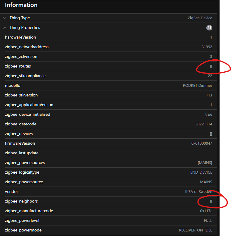

So this means that if both “routes” and “neighbors” is empty, the device has a direct connection to the coordinator? Which is hardly impossible, since the device listed below does not work without a plug/repeater in between.
In the example you are showing the zigbee_logicaltype is a END_DEVICE
so no it will not list routes or neighbors.
just like this device
which happens to be a battery powered temperature sending device. but as you see its classified as a END_DEVICE not a ROUTER

So it does not present you with routing information.
Thanks. You’re right (I just checked), all my outlet-powered devices are classified as ROUTER.
What’s still strange is that my battery-powered devices in the yard (which don’t work with the Routers being active) don’t have any info under “neighbors” or “routes”, which is maybe an incomplete information unter “Things”.

Right and circling all the way back to the earlier comments fully compliant mains powered devices are normally expected ('should") have ROUTER functionality and report ROUTER as zigbee_logicaltype but clearly the one you have posted seems to be some kind of one off or “non standard” since it is MAINS powered and identifies as an END_DEVICE. I have seen that in the past with some of the cheaper off brands too.
It’s a battery device, so it should be an end device, but clearly the device is mis-reporting that it is mains powered. This doesn’t really matter as it shouldn’t be used for anything IIRC. It’s not uncommon for some of these lesser used attributes to be incorrect.
Edit: Sorry - I think we’re talking cross purposes. I was responding to the statement about “battery powered devices in the yard” where I think your comment was about an early post…
All good!
OP’s last screen shot showed a MAINS powered device that was a MODEL RODRET Dimmer and reported as being an END_DEVICE is what I was referring to.
