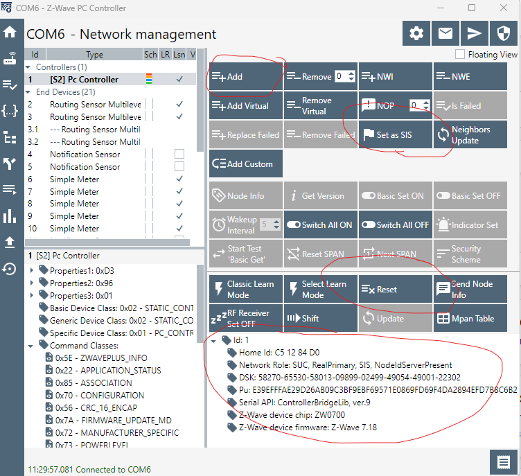

Try this; copy the controller id (after the zwave:serial_zstick:xxxxxxxx. Delete your zstick thing. Go to inbox to create bridge. Paste the Id (xxxxxx). Go to the advanced and made sure sis_node is 1. Create thing. See if there is a controller in the userdata/zwave.
Edit actually take that back. I don’t know how this got so messed up. If the copy above was the Minoston and not the controller, the controller sis_node should not be one. Revised suggestion On the controller UI page hard reset the controller, delete controller thing, then create a new bridge as node 1. See if there is a controller in the userdata/zwave as node 1. If we get that far we can deal with the Minoston next.
Sorry, I should have labeled it. I thought it was from the controller, but I brought the system home to work on it, and now the controller thing doesn’t show the controller properties, and the switch thing properties looks almost the same as the controller properties. AND… (if that wasn’t bad enough) the controller properties don’t show anymore. I am able to access the Serial Port information (533D004242) (/dev/serial/by-id/usb-Zooz_800_Z-Wave_Stick_533D004242-if00).
Is that any help?
Edit: I did what you said )at least what I think you said). I did a hard reset on the controller, then deleted it. I set up a new controller/bridge. I tried to find the userdata directory, but can’t.
Well it is good the controller id is on the rpi, but needs to be in OH.

I think the controller needs to be reset to factory and it doesn’t appear from earlier steps that it is possible in OH. There is still the same sis_node problem
Get the Silabs program insert stick, go to network management. You’ll see this (hopefully with just the controller)
PC Controller 2024-12-22 113119
  1. hit reset
  2. Set as sis-node
    for grins you could also use the ADD+ to include you ministon. Then go back to OH and try to add bridge.
Edit Reasoning: from the Zwave log viewer it seems the controller has a node 0 assignment and node 1 (the actual controller) is id’ed as a slave which is not right.
log viewer 2024-12-22 113952
