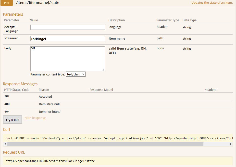

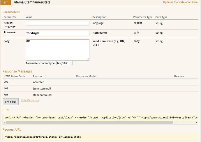

i went to the REST API Documentation again > section items > put (state) and there i entered my item and the state “ON”:
so what http-command should the doorbell send to openHAB?
http://openhabianpi:8080/rest/items/Torklingel/state just tells me the state - but i the doorbell to set the state, not get the state.
You need to issue an HTTP PUT command with the body of “ON” and a content type of “text/plain”.
If you are just getting the state back you are issuing an HTTP GET, not a PUT.
but i’m in the PUT section (see screenshot), right? where - if not there - can i get the right HTTP PUT Command?
i hope it’s not the curl command? tried that already and doesn’t work (probably because the door station doesn’t support this).
There are several HTTP commands that can be sent. This is part of the HTTP protocol. They are all different and they all go to the same URL.
In the curl command the -X PUT is what tells curl to issue an HTTP PUT command. By default, (i.e. without that argument) it will use a GET.
You need to have your weather station send an HTTP PUT command. If you don’t have that option on the weather station then it will only send a GET command and the REST API approach will not work.
