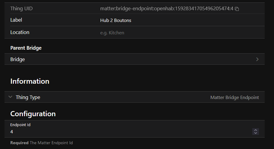

Here are thing properties once added:
Matter bridged devices have no bridge defined:
When I click on the bridge field to select a bridge thing, the proposed list is empty.
I understood that they should have the Matter bridge as bridge thing, that is in my case this one:
Do I misunderstood ?

These should be discovered automatically in the inbox once the parent node was added. Are you creating these manually? Are you saying that the discovered bridge-endpoint thing is discovered but without a bridge set?
Yes, they were discovered automatically once I added the matter bridge as thing.
Yes, they are apparently discovered without a bridge set and even worst you cannot set any bridge to it.

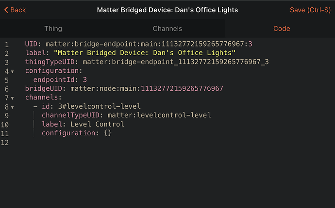

If you look at the “code” tab for that thing, is the bridge set there? Like this ?
The binding is using a Dynamic Thing Type so we can dynamically add channels groups, similar to the mqtt binding, which was a new technique to me, i may have missed something thats confusing the MainUI.
Yes, there is a bridge set:
