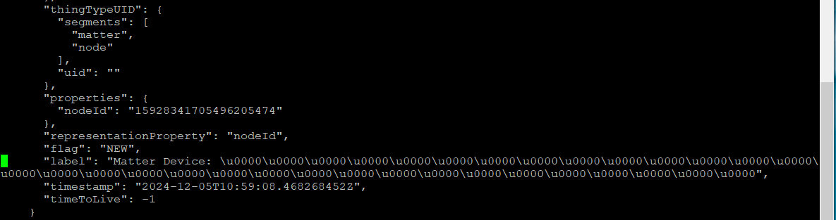

Look at what contains the inbox (JSON), strange unicode characters in label.
Maybe they have to be filtered ?
I added logs in class MatterDiscoveryService.
12:48:57.512 [DEBUG] [rnal.discovery.MatterDiscoveryService] - discoverThing: matter:node:openhab:15928341705496205474 matter:controller:openhab {}
12:48:57.517 [DEBUG] [rnal.discovery.MatterDiscoveryService] - initial label 14 Matter Device:
12:48:57.521 [DEBUG] [rnal.discovery.MatterDiscoveryService] - vendorName 9 SwitchBot
12:48:57.524 [DEBUG] [rnal.discovery.MatterDiscoveryService] - productName 15 SwitchBot Hub 2
12:48:57.528 [DEBUG] [rnal.discovery.MatterDiscoveryService] - nodeLabel 32
12:48:57.531 [DEBUG] [rnal.discovery.MatterDiscoveryService] - fixedLabel 0
12:48:57.535 [DEBUG] [rnal.discovery.MatterDiscoveryService] - final label 47 Matter Device:
The problem is that there is a strange value in nodeLabel but you have everything needed in vendorName / productName.
You should apply a filter on nodeLabel / vendorName / productName to erase unexpected charcaters. Then in my case, nodeLabel will then be empty and your code will then use vendorName / productName. This would lead in my case to ā€œMatter Device: SwitchBot SwitchBot Hub 2ā€. An additional improvement would be to not include the vendor name in case the product name starts with the vendor name, so that I will finally get ā€œMatter Device: SwitchBot Hub 2ā€.
Considering my capture in my previous message, nodeLabel contains value 0 32 times.
Maybe simply applying trim() would solve the issue?

I need your JSON file to speed up fixing this.. I am attempting to pull the endpoint name from a few different clusters. Endpoints contain a few different ā€œlabelā€ clusters, there is the BasicInformationCluster and BridgedDeviceBasicInformationCluster which offer vendor name, product name and a node label. Unfortunately is kinda up to the manufacturer to put sane values there. There is also a FixedLabelCluster which offers key=value pairs of labels for the endpoint, as well as a UserLabelCluster which is similar (but user provided). I cycle through all of these if they exist trying to build a logical endpoint name. I know this is something i need to come back to once i have enough examples of real world devices out there. Its not clear to me how manufactuers are using these togeather.
Just reading your second post, i’ll take a look at that, I only trim the final value, so yes i could see i’m matching on these null characters, although i’m still curious what the JSON looks like to know if i should also be fixing my node serialization logic on the typescript side to prevent this from even getting to openHAB
As previously mentioned, the problem in my case is in nodeLabel contains 32 0 !! That is not a valid string.

Thats a very odd node label, do you know what the significance is there, why the vendor may have set that (maybe you have context, i’m not familiar with that hardware) ? I was hoping Node label would be the primary endpoint label (sounds like it should be) .

But we can try to be robust and handle this case. You already tried to do it as you handle the case of an empty nodeLabel.
Dan, I sent to you the full JSON.
Here is a small extract showing what is the problem:
Don’t know if the problem is the tools we are using / developing or in Switchbot device itself.

Yeah, given your JSON data, i would say the Switchbot is not using the matter standard as it should (like no labels on bridged endpoints!).
