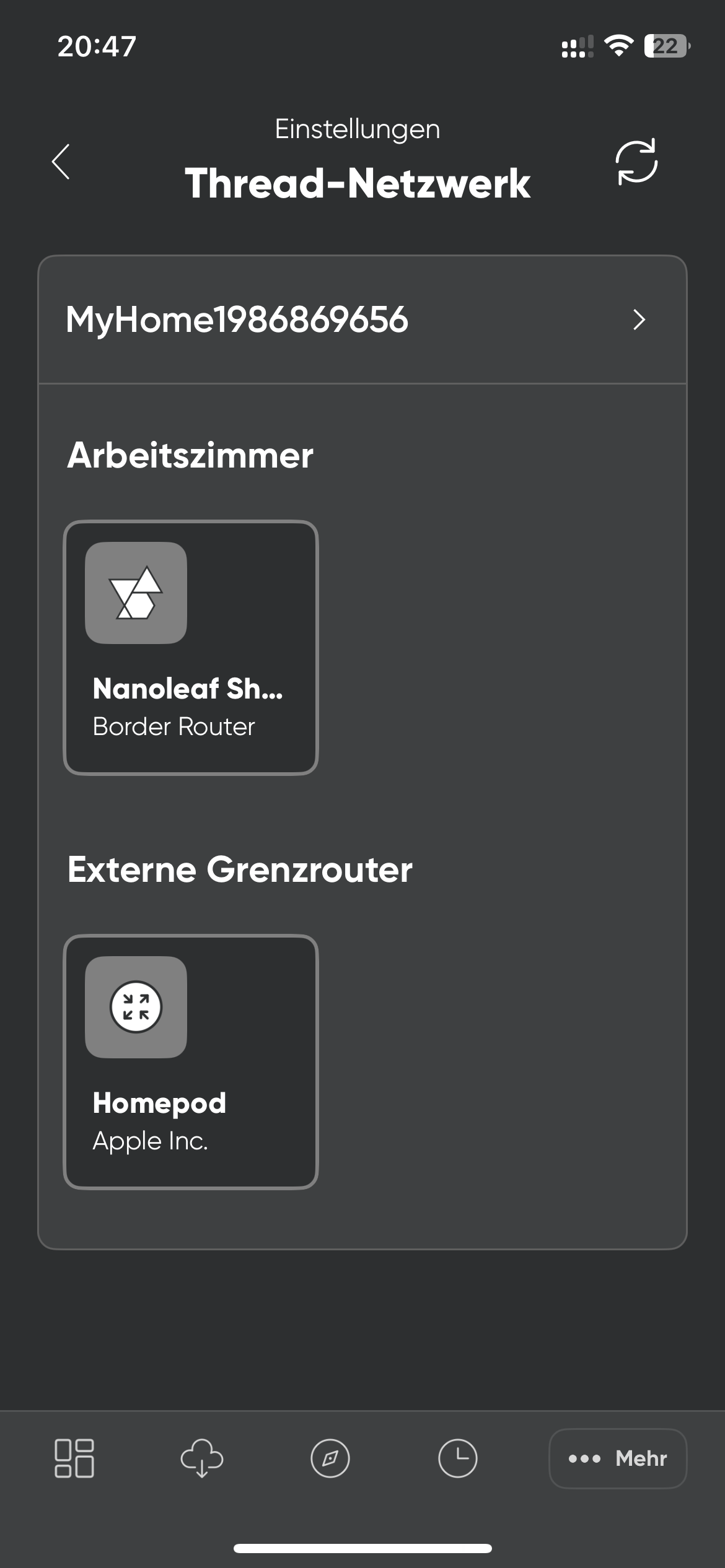

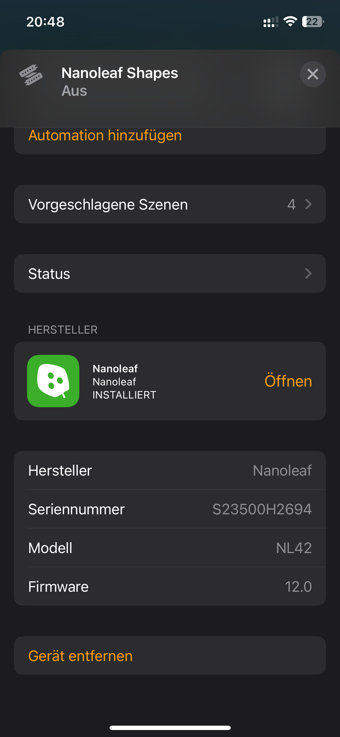

I read the readme carefully and understand the basic concept I think. I already paired the Nanoleaf border router with my HomeKit. In order to add it to openhab I need to generate a new pairing code, but I cannot find a way to do so in the Apple home app. In the Nanoleaf app, there is a button called connect API. I used this code to connect the controller to the Nanoleaf binding, but it doesn’t seem to be the matter pairing code
I found an article where the process is described. The Nanoleaf device I added to HomeKit does not provide the option to generate a pairing code inside the Home app. Tomorrow, I will try to reset the device and pair it with openhab at first and the home app later.

So a thread boarder gateway is not a matter device, so it can not be “commissioned”. Apple homekit is exchanging thread credentials so it can use it as a thread router (no matter invloved at this point). We don’t yet support adding thread routers like this yet, but it not a problem right now in your case.
Now that your thread boarder router is useable by Apple, you should be able to add matter devices to that in Apple Home. Once thats done, you generate a pairing code from the Matter device in the apple home UI and use that to pair. You should not have to do anything with the router in the apple home ui.
openHAB will talk directly to the thread boarder router that the device is using at this point, and Apple Home will not be involved anymore. If you remove the router from Apple, openHAB will still be able to talk to it and control any devices that are already paired.

The router in question here is not your internet router but the thread border router. You can unpair it from Apple or Google and still keep the connection with openHAB.
Matter is not dependent on any cloud, so you can switch off your internet connection and still control devices locally.

I managed to install the Addon and found the matter downlight in the home-app.
Indeed it is possible to set it into pairing mode there.

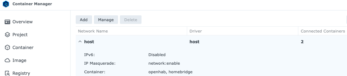

If you have a thread device, you will need to make sure your OpenHAB machine is IP6 enabled.

 I hope i can get it to work (docker on synology nas)

Hmm, that could tough, Docker disables ipv6 by default, but since its managed by synsolgy in this case, you’ll have to figure out how to enable that within their configuration management. A quick google on “synology docker ipv6” and the first results are people struggling to get matter working on this setup , so i guess we are not alone there.
