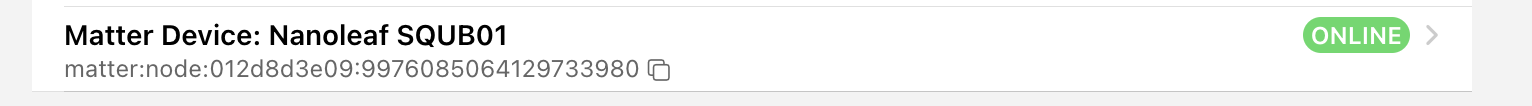

What is weird about this ^, I added the thing as follows:
and when I rescan it comes up again in my inbox:
2024-12-08 10:51:51.741 [DEBUG] [al.controller.MatterControllerClient] - onWebSocketText {"type":"response","message":{"type":"resultSuccess","id":"616a2098-0956-4072-9d6f-4a3ec7b07530","result":{"id":"5860659056090857746","rootEndpoint":{"number":0,"clusters":{"Groups":{"id":4,"name":"Groups","nameSupport":{"nameSupport":true,"groupNames":true},"clusterRevision":4,"featureMap":{"groupNames":true},"attributeList":[0,65528,65529,65531,65532,65533],"acceptedCommandList":[0,1,2,3,4,5],"generatedCommandList":[0,1,2,3]},"Descriptor":{"id":29,"name":"Descriptor","deviceTypeList":[{"deviceType":22,"revision":1}],"serverList":[4,29,31,40,48,49,51,53,60,62,63,64,65],"clientList":[],"partsList":[1],"clusterRevision":1,"featureMap":{"tagList":false},"attributeList":[0,1,2,3,65528,65529,65531,65532,65533],"acceptedCommandList":[],"generatedCommandList":[]},"AccessControl":{"id":31,"name":"AccessControl","acl":[{"privilege":5,"authMode":2,"subjects":["1651454442726409342"],"targets":null,"fabricIndex":2}],"extension":[],"subjectsPerAccessControlEntry":4,"targetsPerAccessControlEntry":3,"accessControlEntriesPerFabric":3,"clusterRevision":1,"featureMap":{},"attributeList":[0,1,2,3,4,65528,65529,65531,65532,65533],"acceptedCommandList":[],"generatedCommandList":[]},"BasicInformation":{"id":40,"name":"BasicInformation","dataModelRevision":1,"vendorName":"Nanoleaf","vendorId":5142,"productName":"SQUB01","productId":2817,"nodeLabel":"","location":"XX","hardwareVersion":100,"hardwareVersionString":"1.0.0","softwareVersion":197120,"softwareVersionString":"3.5.46","manufacturingDate":"20200101","partNumber":"","productUrl":"","productLabel":"Cono Lamp","serialNumber":"S24020CO0013B","localConfigDisabled":false,"reachable":true,"uniqueId":"6DCE34A8FB376FFE","capabilityMinima":{"caseSessionsPerFabric":3,"subscriptionsPerFabric":3},"clusterRevision":1,"featureMap":{},"attributeList":[0,1,2,3,4,5,6,7,8,9,10,11,12,13,14,15,16,17,18,19,65528,65529,65531,65532,65533],"acceptedCommandList":[],"generatedCommandList":[]},"GeneralCommissioning":{"id":48,"name":"GeneralCommissioning","breadcrumb":0,"basicCommissioningInfo":{"failSafeExpiryLengthSeconds":60,"maxCumulativeFailsafeSeconds":900},"regulatoryConfig":0,"locationCapability":0,"supportsConcurrentConnection":true,"clusterRevision":1,"featureMap":{},"attributeList":[0,1,2,3,4,65528,65529,65531,65532,65533],"acceptedCommandList":[0,2,4],"generatedCommandList":[1,3,5]},"NetworkCommissioning":{"id":49,"name":"NetworkCommissioning","maxNetworks":1,"networks":[{"networkId":"6db3e577647a47e5","connected":true}],"interfaceEnabled":true,"lastNetworkingStatus":0,"lastNetworkId":"6db3e577647a47e5","lastConnectErrorValue":null,"scanMaxTimeSeconds":10,"connectMaxTimeSeconds":20,"clusterRevision":1,"featureMap":{"wiFiNetworkInterface":false,"threadNetworkInterface":true,"ethernetNetworkInterface":false},"attributeList":[0,1,2,3,4,5,6,7,65528,65529,65531,65532,65533],"acceptedCommandList":[0,3,4,6,8],"generatedCommandList":[1,5,7]},"GeneralDiagnostics":{"id":51,"name":"GeneralDiagnostics","networkInterfaces":[{"name":"NEST-PAN-9ACB","isOperational":true,"offPremiseServicesReachableIPv4":null,"offPremiseServicesReachableIPv6":null,"hardwareAddress":"5c590220005b0215","iPv4Addresses":[],"iPv6Addresses":[],"type":4}],"rebootCount":98,"upTime":85,"totalOperationalHours":0,"bootReason":1,"activeHardwareFaults":[],"activeRadioFaults":[],"activeNetworkFaults":[],"testEventTriggersEnabled":false,"clusterRevision":1,"featureMap":{"dataModelTest":false},"attributeList":[0,1,2,3,4,5,6,7,8,65528,65529,65531,65532,65533],"acceptedCommandList":[0],"generatedCommandList":[]},"ThreadNetworkDiagnostics":{"id":53,"name":"ThreadNetworkDiagnostics","channel":18,"routingRole":5,"networkName":"NEST-PAN-9ACB","panId":39627,"extendedPanId":"7904914071914956773","meshLocalPrefix":"40fd40bdb457210000","neighborTable":[{"extAddress":"11997219996963235066","age":7,"rloc16":32768,"linkFrameCounter":1115146,"mleFrameCounter":134618,"lqi":3,"averageRssi":-51,"lastRssi":-58,"frameErrorRate":0,"messageErrorRate":0,"rxOnWhenIdle":true,"fullThreadDevice":true,"fullNetworkData":true,"isChild":false},{"extAddress":"10866334939741329580","age":1,"rloc16":43008,"linkFrameCounter":980572,"mleFrameCounter":207744,"lqi":3,"averageRssi":-78,"lastRssi":-79,"frameErrorRate":7,"messageErrorRate":0,"rxOnWhenIdle":true,"fullThreadDevice":true,"fullNetworkData":true,"isChild":false}],"routeTable":[{"extAddress":"9127028302924215504","rloc16":26624,"routerId":26,"nextHop":42,"pathCost":1,"lqiIn":3,"lqiOut":0,"age":0,"allocated":true,"linkEstablished":false},{"extAddress":"11997219996963235066","rloc16":32768,"routerId":32,"nextHop":42,"pathCost":2,"lqiIn":3,"lqiOut":3,"age":7,"allocated":true,"linkEstablished":true},{"extAddress":"1063392863961549170","rloc16":35840,"routerId":35,"nextHop":63,"pathCost":0,"lqiIn":0,"lqiOut":0,"age":0,"allocated":true,"linkEstablished":false},{"extAddress":"10866334939741329580","rloc16":43008,"routerId":42,"nextHop":32,"pathCost":2,"lqiIn":3,"lqiOut":3,"age":1,"allocated":true,"linkEstablished":true},{"extAddress":"2230874439864341391","rloc16":54272,"routerId":53,"nextHop":42,"pathCost":4,"lqiIn":0,"lqiOut":0,"age":12,"allocated":true,"linkEstablished":false}],"partitionId":1543132435,"weighting":65,"dataVersion":250,"stableDataVersion":31,"leaderRouterId":26,"activeTimestamp":"108795968661471","pendingTimestamp":0,"delay":0,"securityPolicy":{"rotationTime":672,"flags":8207},"channelPage0Mask":"001fffe0","operationalDatasetComponents":{"activeTimestampPresent":true,"pendingTimestampPresent":false,"masterKeyPresent":true,"networkNamePresent":true,"extendedPanIdPresent":true,"meshLocalPrefixPresent":true,"delayPresent":false,"panIdPresent":true,"channelPresent":true,"pskcPresent":true,"securityPolicyPresent":true,"channelMaskPresent":true},"activeNetworkFaultsList":[0,0,0,0],"clusterRevision":1,"featureMap":{"packetCounts":true,"errorCounts":true,"mleCounts":true,"macCounts":true},"attributeList":[0,1,2,3,4,5,6,7,8,9,10,11,12,13,14,15,16,17,18,19,20,21,22,23,24,25,26,27,28,29,30,31,32,33,34,35,36,37,38,39,40,41,42,43,44,45,46,47,48,49,50,51,52,53,54,55,56,57,58,59,60,61,62,65528,65529,65531,65532,65533],"acceptedCommandList":[0],"generatedCommandList":[],"overrunCount":0,"detachedRoleCount":1,"childRoleCount":1,"routerRoleCount":1,"leaderRoleCount":0,"attachAttemptCount":1,"partitionIdChangeCount":1,"betterPartitionAttachAttemptCount":0,"parentChangeCount":0,"txTotalCount":660,"txUnicastCount":650,"txBroadcastCount":11,"txAckRequestedCount":652,"txAckedCount":646,"txNoAckRequestedCount":11,"txDataCount":666,"txDataPollCount":0,"txBeaconCount":0,"txBeaconRequestCount":0,"txOtherCount":0,"txRetryCount":173,"txDirectMaxRetryExpiryCount":7,"txIndirectMaxRetryExpiryCount":0,"txErrCcaCount":0,"txErrAbortCount":0,"txErrBusyChannelCount":0,"rxTotalCount":274,"rxUnicastCount":227,"rxBroadcastCount":34,"rxDataCount":264,"rxDataPollCount":0,"rxBeaconCount":0,"rxBeaconRequestCount":0,"rxOtherCount":0,"rxAddressFilteredCount":0,"rxDestAddrFilteredCount":0,"rxDuplicatedCount":3,"rxErrNoFrameCount":0,"rxErrUnknownNeighborCount":16,"rxErrInvalidSrcAddrCount":0,"rxErrSecCount":0,"rxErrFcsCount":0,"rxErrOtherCount":0},"AdministratorCommissioning":{"id":60,"name":"AdministratorCommissioning","windowStatus":0,"adminFabricIndex":null,"adminVendorId":null,"clusterRevision":1,"featureMap":{"basic":false},"attributeList":[0,1,2,65528,65529,65531,65532,65533],"acceptedCommandList":[0,1,2],"generatedCommandList":[]},"OperationalCredentials":{"id":62,"name":"OperationalCredentials","nocs":[{"noc":"153001010324020137032414001826041b90e62c26059bc693413706241501271112c1f8435c3e55511824070124080130094104f278fd521b54688dcc47c47ad1df098df6fc008e60e660367744147c9b5ba2fd0facaa5ef3f825e59a604cdaab47efbf0a811ff3340c73e5f58f467cbad99387370a350128011824020136030402040118300414fa0972b309e74d24a8f236ee4cd507aa0dbd8b37300514b7c69fa09014efd99b65c8b0f059266795fb742918300b4051fae95483d431f4a0a08159af65a17d92c3e787d192d51873720aa2630be57f4a69937ee9ca1f125a72a9c0d780f96ed213fb3cbcf529406a783ab896832cb918","icac":null,"fabricIndex":2}],"fabrics":[{"rootPublicKey":"0499b376be68dded3b2b099c9f6f629e4e9f229240f2e65af2122d079021d21fb7481101aac3a276be6d63ab34a91422c365e77d6bf6bae4a9b882f9a0cfd6ad8d","vendorId":65521,"fabricId":"1","nodeId":"5860659056090857746","label":"","fabricIndex":2}],"supportedFabrics":5,"commissionedFabrics":2,"trustedRootCertificates":["153001010124020137032c840255532c0706476f6f676c652c010b4d617474657220526f6f74271401000000feffffff1826047fd2432926057f945be537062c840255532c0706476f6f676c652c010b4d617474657220526f6f74271401000000feffffff18240701240801300941045b37df6549c20dc8d722a6b8acb660a8a764ce7baf6c6c224f7ee84349684ad7d809ff650033d1527dcf1fbaac6a9c3ad8b41edac909f7b5c760fd542c892375370a350129012402011824026030041472c201f7571913b348ca00ca7b45f4774668c97e30051472c201f7571913b348ca00ca7b45f4774668c97e18300b4065164b166adff18c15610a8ce91bd703e9c1f677b711ce133505152df0da15111675ac5591cee786851cdd9efdad296674bebcb2a3a3209bcde7b309db552c6f18","15300101002402013703241400182604377fe62c2605b7b593413706241400182407012408013009410499b376be68dded3b2b099c9f6f629e4e9f229240f2e65af2122d079021d21fb7481101aac3a276be6d63ab34a91422c365e77d6bf6bae4a9b882f9a0cfd6ad8d370a3501290118240260300414b7c69fa09014efd99b65c8b0f059266795fb7429300514b7c69fa09014efd99b65c8b0f059266795fb742918300b40f5e1a39beb776ade2b05dbe52c475572c72799ccad02a8e0756b6f69e80fb20a2c954e7fb09cd1e7a2c17c2303d48985a7533178ba92edacda606b9b5104fc4318"],"currentFabricIndex":2,"clusterRevision":1,"featureMap":{},"attributeList":[0,1,2,3,4,5,65528,65529,65531,65532,65533],"acceptedCommandList":[0,2,4,6,7,9,10,11],"generatedCommandList":[1,3,5,8]},"GroupKeyManagement":{"id":63,"name":"GroupKeyManagement","groupKeyMap":[],"groupTable":[],"maxGroupsPerFabric":3,"maxGroupKeysPerFabric":3,"clusterRevision":1,"featureMap":{"cacheAndSync":false},"attributeList":[0,1,2,3,65528,65529,65531,65532,65533],"acceptedCommandList":[0,1,3,4],"generatedCommandList":[2,5]},"FixedLabel":{"id":64,"name":"FixedLabel","labelList":[{"label":"room","value":"bedroom 2"},{"label":"orientation","value":"North"},{"label":"floor","value":"2"},{"label":"direction","value":"up"}],"clusterRevision":1,"featureMap":{},"attributeList":[0,65528,65529,65531,65532,65533],"acceptedCommandList":[],"generatedCommandList":[]},"UserLabel":{"id":65,"name":"UserLabel","labelList":[],"clusterRevision":1,"featureMap":{},"attributeList":[0,65528,65529,65531,65532,65533],"acceptedCommandList":[],"generatedCommandList":[]}},"children":[{"number":1,"clusters":{"Identify":{"id":3,"name":"Identify","identifyTime":0,"identifyType":2,"clusterRevision":4,"featureMap":{},"attributeList":[0,1,65528,65529,65531,65532,65533],"acceptedCommandList":[0,64],"generatedCommandList":[]},"Groups":{"id":4,"name":"Groups","nameSupport":{"nameSupport":true,"groupNames":true},"clusterRevision":4,"featureMap":{"groupNames":true},"attributeList":[0,65528,65529,65531,65532,65533],"acceptedCommandList":[0,1,2,3,4,5],"generatedCommandList":[0,1,2,3]},"Unknown cluster 0x5":{"id":5,"name":"Unknown cluster 0x5","clusterRevision":4,"featureMap":{},"attributeList":[0,1,2,3,4,65528,65529,65531,65532,65533],"acceptedCommandList":[0,1,2,3,4,5,6,64,65,66],"generatedCommandList":[0,1,2,3,4,6,64,65,66],"unknownAttribute_0x0":0,"unknownAttribute_0x1":0,"unknownAttribute_0x2":0,"unknownAttribute_0x3":false,"unknownAttribute_0x4":0},"OnOff":{"id":6,"name":"OnOff","onOff":true,"clusterRevision":4,"featureMap":{"lighting":true,"deadFrontBehavior":false,"offOnly":false},"attributeList":[0,16384,16385,16386,16387,65528,65529,65531,65532,65533],"acceptedCommandList":[0,1,2,64,65,66],"generatedCommandList":[],"globalSceneControl":true,"onTime":1,"offWaitTime":1,"startUpOnOff":1},"LevelControl":{"id":8,"name":"LevelControl","currentLevel":122,"maxLevel":254,"options":{"executeIfOff":false,"coupleColorTempToLevel":false},"onOffTransitionTime":1,"onLevel":122,"clusterRevision":5,"featureMap":{"onOff":true,"lighting":true,"frequency":false},"attributeList":[0,1,2,3,15,16,17,16384,65528,65529,65531,65532,65533],"acceptedCommandList":[0,1,2,3,4,5,6,7],"generatedCommandList":[],"minLevel":1,"remainingTime":0,"startUpCurrentLevel":254},"Descriptor":{"id":29,"name":"Descriptor","deviceTypeList":[{"deviceType":269,"revision":1}],"serverList":[3,4,5,6,8,29,30,768],"clientList":[],"partsList":[],"clusterRevision":1,"featureMap":{"tagList":false},"attributeList":[0,1,2,3,65528,65529,65531,65532,65533],"acceptedCommandList":[],"generatedCommandList":[]},"Binding":{"id":30,"name":"Binding","binding":[],"clusterRevision":1,"featureMap":{},"attributeList":[0,65528,65529,65531,65532,65533],"acceptedCommandList":[],"generatedCommandList":[]},"ColorControl":{"id":768,"name":"ColorControl","remainingTime":0,"colorMode":2,"options":{"executeIfOff":false},"numberOfPrimaries":null,"enhancedColorMode":2,"colorCapabilities":{"hueSaturation":true,"enhancedHue":false,"colorLoop":false,"xy":true,"colorTemperature":true},"clusterRevision":5,"featureMap":{"hueSaturation":true,"enhancedHue":false,"colorLoop":false,"xy":true,"colorTemperature":true},"attributeList":[0,1,2,3,4,7,8,15,16,16385,16394,16395,16396,16397,16400,65528,65529,65531,65532,65533],"acceptedCommandList":[0,1,2,3,4,5,6,7,8,9,10,64,65,66,67,68,71,75,76],"generatedCommandList":[],"currentHue":0,"currentSaturation":0,"currentX":0,"currentY":0,"colorTemperatureMireds":370,"colorTempPhysicalMinMireds":153,"colorTempPhysicalMaxMireds":470,"coupleColorTempToLevelMinMireds":0,"startUpColorTemperatureMireds":null}},"children":[]}]}},"error":"undefined"}}
2024-12-08 10:51:51.743 [DEBUG] [al.controller.MatterControllerClient] - result type: resultSuccess
2024-12-08 10:51:51.760 [DEBUG] [al.controller.MatterControllerClient] - Cluster not found: Unknown cluster 0x5
2024-12-08 10:51:51.763 [DEBUG] [r.internal.handler.ControllerHandler] - discoverChildNode 5860659056090857746
2024-12-08 10:51:51.764 [DEBUG] [nal.discovery.MatterDiscoveryService] - discoverThing: matter:node:012d8d3e09:5860659056090857746 matter:controller:012d8d3e09 5860659056090857746
2024-12-08 10:51:51.870 [INFO ] [g.discovery.internal.PersistentInbox] - Added new thing 'matter:node:012d8d3e09:5860659056090857746' to inbox.
2024-12-08 10:51:51.871 [DEBUG] [r.internal.handler.ControllerHandler] - updateNode END 5860659056090857746
with a slightly different id.

This shows it picked up your existing Matter Fabric , with 2 nodes "9976085064129733980","5860659056090857746"
There are no handlers b/c you deleted those things previously per the instructions and now you scan and then add them back, then the handlers will be there. So theres no problem here.
Did you hard reset the device? The id is generated by the controller (openHAB) when a device is commissioned, and so changes each time its paired, so if you hard reset the device, but did not decommission it first from openHAB, it still thinks that existing ID is assigned to a device. Since you paired it again, we think there are 2 devices. There is a thing action to decommission a node, you can use that to remove it.
