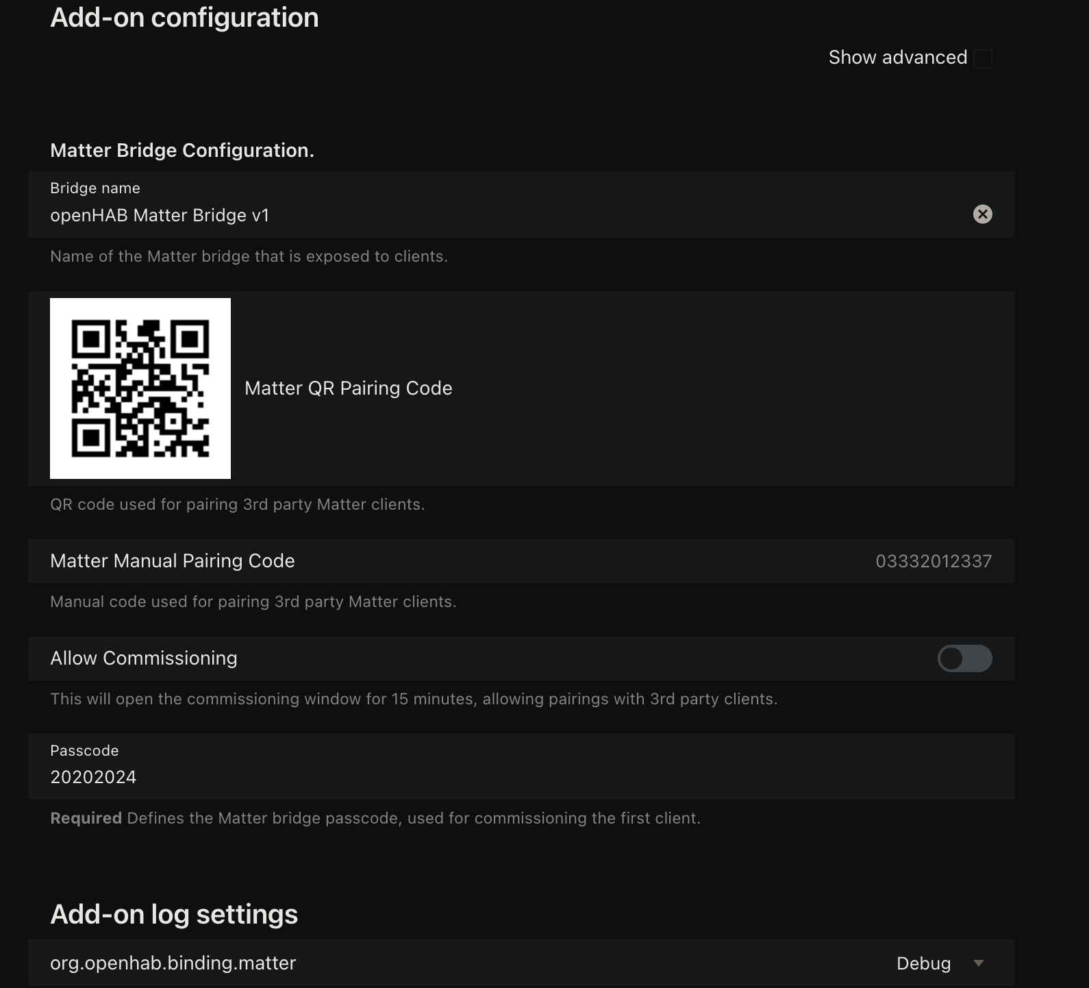

I’m still trying to get Alexa to find the OH matter bridge. I have Google Home paired without issue. I go to the Google Home app and find the OH Matter device and go to Linked Matter apps & services. Then I click on ‘Link apps & services’. OH then prints the messages below. I use the link in the Google Home app to link with Alexa. Alexa initially says it is connecting to the device, but then says it can’t connect. I never see anything in the log when Alexa is trying to connect.
I use the exact same phone to connect Google Home and it works fine. If I disconnect Google Home and try to connect Alexa, I get similar symptoms, connecting, then ‘can’t connect’.
The OH runs on a Linux box with a LAN connection to the router. Everything else is through the wifi. Since Google Home works and uses the same network, I don’t suspect issues, but obviously something is different.
I did set the accept_ra to 1, and I set the aaccept_ra_rt_info_max_plen to 64. Because GH works, I think these must be set correctly? IPV6 is enabled and it works for GH. Also, I have Matter wifi devices that OH can connect to. The only issue I have is getting Alexa to see the OH Matter bridge.

What link, like a URL? Or is this a QR code or a code like 1234-567-8901 ? This sounds like a pairing code issue since its working with GH. Also the binding allows you to enable commissioning with multiple controllers without having to go to say your google home (although that should work as well). Go to he matter settings in the Main UI (Settings → Add On Settings) and click “Allow Commissioning” and hit save , this will open the window up for 15 mins and you can use the QR code and numeric code in that screen (see screen shot of mine, but yours will be different)
These are only needed when controlling matter thread based devices directly from openhab, but not for exposing items in this case.

Same result with using the OH ‘Allow Commissioning’. Alexa says looking for the device, connecting to the device, then failed to connect. During this process nothing new is shown in the OH log. I’ve put the log below which starts when I do the save after allow commissioning. Does it point to anything?
This same process works fine with Google Home.
