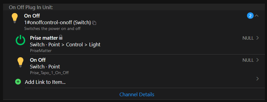

@digitaldan : I tried also with managed items and they are also not set at OH startup. And matter node things are also concerned (in fact all things) like in my example (one item is defined in file and one was defined with Main UI):
For this Tapo matter plug, if I change its state outside OH, I can see the items are immediately updated.
So the problem is really only at OH startup.
I would not be totally surprised if this is in link with dynamic thing types and their storage (I see these two files: org.openhab.binding.matter.internal.MatterChannelTypeProvider-ChannelGroupType.json and org.openhab.binding.matter.internal.MatterChannelTypeProvider-ThingType.json).
Edit: something important to mention: my things are defined in a config file.
