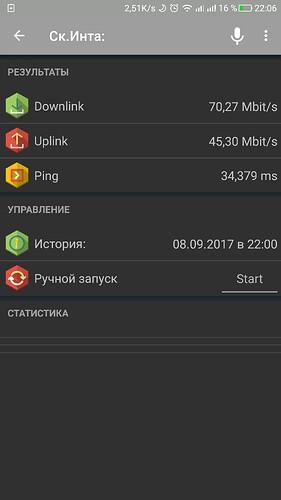

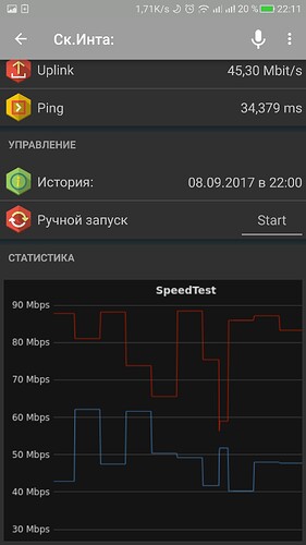

I do not understand. Your examples do not work for me. Only Webview works.
your examples (I tried different versions of altered experiments. nothing succeeded):
Image label="SpeedTest" refresh=60000 url="http://192.168.1.25:3000/render/dashboard-solo/db/openhab?from=now-1h&to=now&panelId=1&theme=light&width=490&height=351&tz=UTC-06%3A00"
Image label="SpeedTest" refresh=60000 url="http://192.168.1.25:3000/render/dashboard-solo/db/openhab?panelId=1&theme=light&width=490&height=351"
Image label="SpeedTest" refresh=60000 url="http://edgi-server:3000/render/dashboard-solo/db/openhab?orgId=1&from=now-1w&to=now&panelId=1&theme=light&$
Image label="SpeedTest" refresh=60000 url="http://edgi-server:3000/render/dashboard-solo/db/openhab?orgId=1&from=now-1M&to=now&panelId=1&theme=light&$
Webview work:
Webview url="http://192.168.1.25:3000/render/dashboard-solo/db/openhab?panelId=1&width=490&height=351&from=now-12h&to=now"

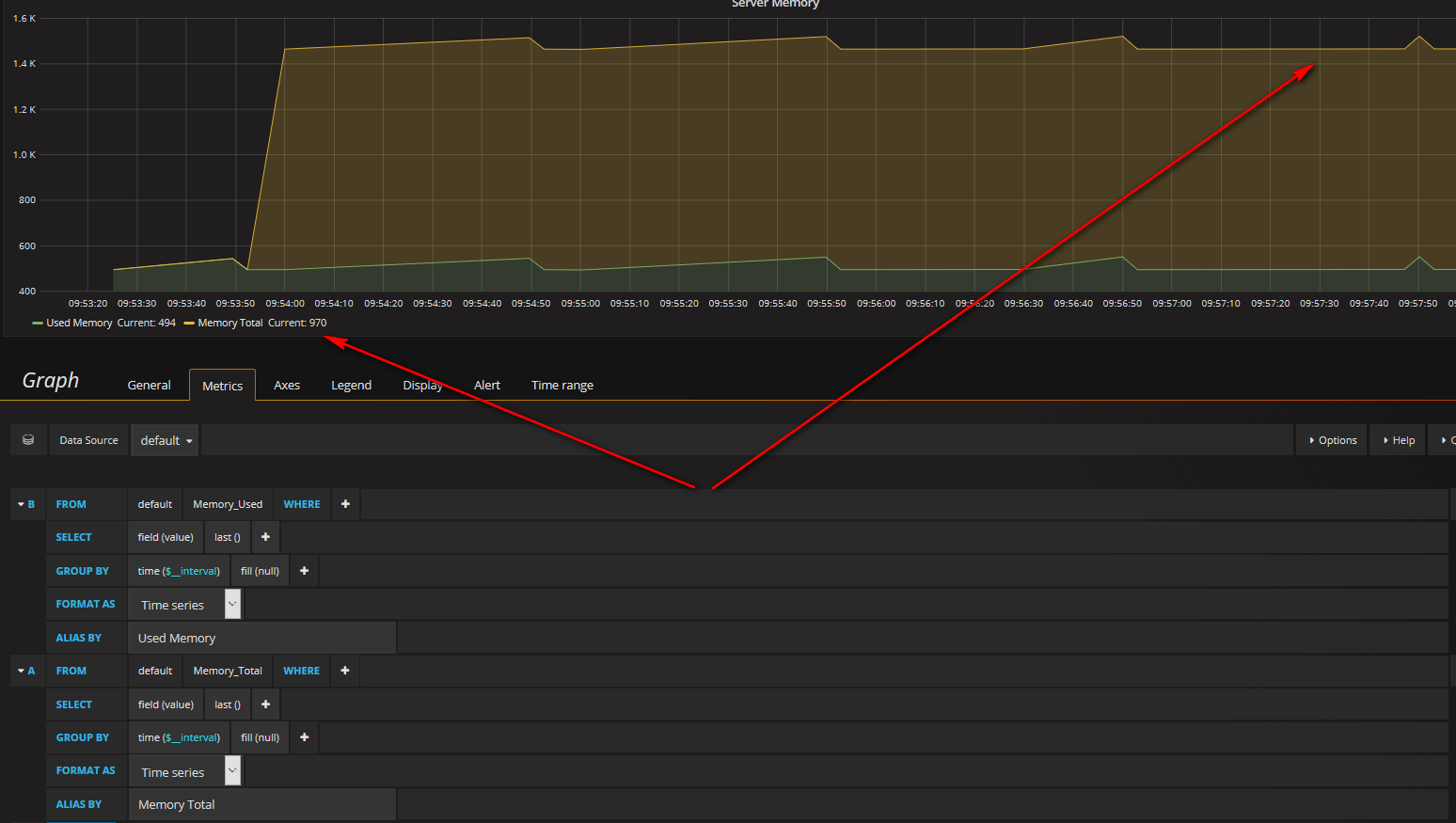

Is anyone able to help me decipher why my grafana chart is showing the incorrect amount on the chart for total memory? I must have set something up wrong? It seems to be showing as the total of both total memory and used memory…
And that is exactly what you’ve configured I suspect
It’s pretty clear because of these little bumps. Go to “Display” and disable “Stack” ![]()
