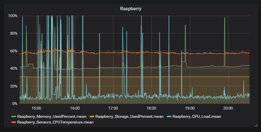

Hey guys, I’m fighting with CPU load while using grafana with influxdb.
I’m using it for temperature graphs, and showing them in habpanel. it looks like storing value into databes works fine. Problem is when I want to display graphs.
My CPU load looks like this:
Grafana:
SELECT mean("value") FROM "Balcony_Humidity" WHERE $timeFilter GROUP BY time(10m) fill(none)
Also when I’m using curl for store graphs into pictures, usualy some of them are empty.
Any idea what I have to look for?
Usetop to determine what process is actually using the CPU. That graph says that the CPU use has spiked but it doesn’t tell you what process is using it. Also remember that each CPU on a machine gets it’s own 100%. So a 100% reading means you are using 100% of one CPU but if there are two CPUs that is only half of the available CPU.
