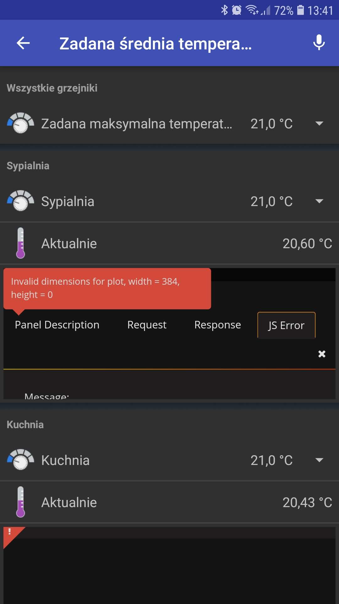

November 18, 2018, 12:52pm
666
Has anyone problem with the recent update of android OpenHAB application?
Grafana in WebView returns error (after tap on exclamation mark):
Invalid dimensions for plot, width = 384, height = 0
In previous OpenHAB android app I saw grafana chart without problems.
