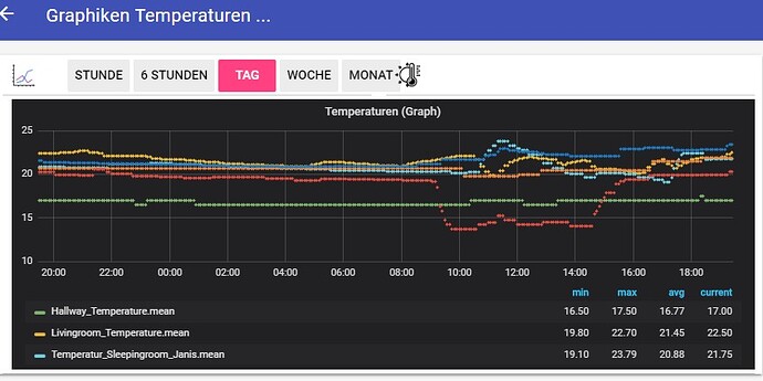

I have running influx and grafana on my Raspberry, and was able to see a “live” graph (5s intervall) on a website (local PC), URL like:
http://192.168.:3000/d/Il-rTUzRk/e-power-kwh-live?orgId=1&panelId=2&fullscreen&from=now-5m&to=now&refresh=5s
I will use this “live graph” on a sitemap (actuall no habpanel), i this possible? How :wink:
Or do I need that Grafana create png-files and I have to show these (but: not easy for a 5s intervall …)
Also: On the PC I have also to login into Grafana to see the graph, is there a “good” way that this not needed?

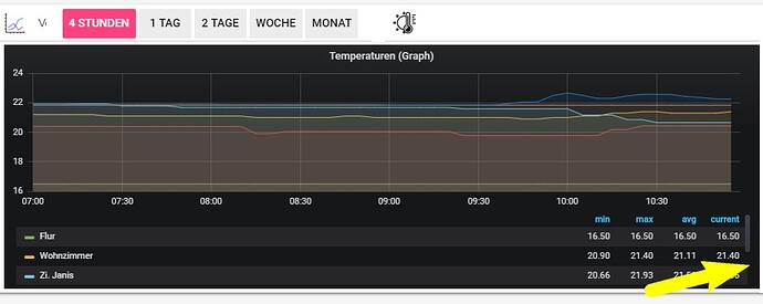

And in Grafana under “Legend” I activate “Show” and “As table”:
But this will only show (the first) three temperature sensores I added (in the graph there are six shown, thats correct). See picture
When activating additionally “To the right”, than all six values are shown on the right part from the screen (but than the graph is to much shrinked). Is this a limitation, a Bug or a mistake on my side?
For the first question, select “connected” for the null value in the Display tab in Grafana. There’s a picture here.
OK, for my second question I found out:
When moving over on the right part, a scroll line appear!
Without move-over there is NO hint that there are more lines!
But in my case it would bether to see all 6 lines directly, is there an option?

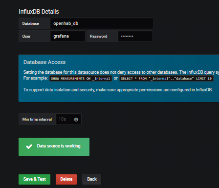

I confess i ventured into installing InfluxDB and Grafana from the openhabian-config>optional components installation ( i thought: “it’s been 2 years ever since Thomas Dietrich wrote this tutorial, let’s be brave!” - btw the tutorial is definitely still relevant, so TY).
The automated setup process sets up most of the things for you, basically all there is left is to install the addon in paperui and schedule a persistence job.
I now have the follwoing situation:
Grafana says it has no issues in connecting to opehab_db from influx as datasource

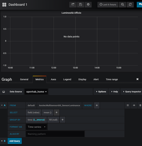

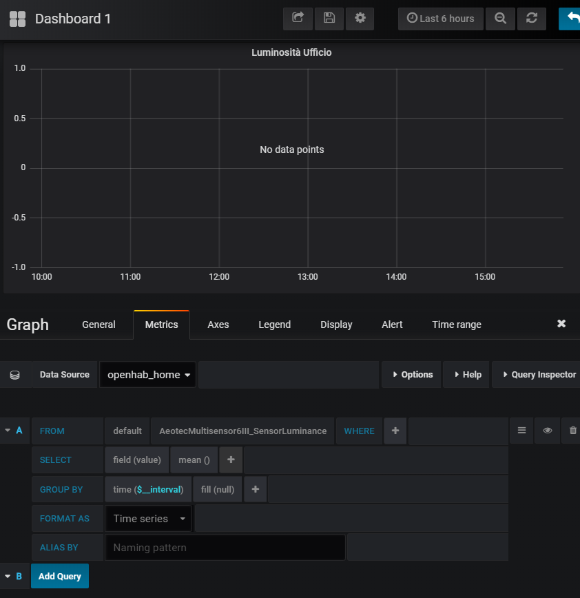

..But when i go creating a graph in my first dashboard
i don’t get any result, except for a “no data points” written in the middle of the graph.
I’m sure i missed something silly (as usual for any first timer the amount of info can be overwhelming).
any pointers?
Thanks!!
EDIT: do i need to write SELECT * FROM … so influxdb CLI commands in the grafana query for it to work??

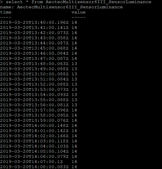

EDIT 2: i’ve tried logging into influx’s CLI with grafana’s credentials and reading the measurements, but got this error:
so i guess the automated process doesn’t do
EDIT for anybody who might face the same issue
if you install Grafana and InfluxDB from the automated procedure in the openhabian-config, you need to log into influx’s CLI as ‘admin’ with the ‘SuperSecretPassword123+’ you’ve set up during the process, and do the 2 GRANT commands above. otherwise it’s not going ot work XD
took me hours (-.-) XD
