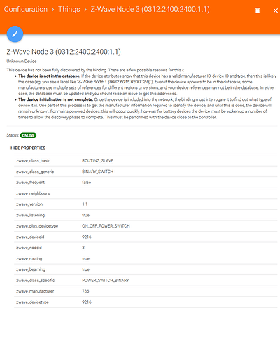

Issue of the topic: Inovelli NZW36 appears as unknown device
I’ve seen this topic from a year ago, but I can’t figure out how to get this device working. Is this a database thing or user error? I’ve just got my controller and a few sensors set up, but I’m hitting a wall with this peripheral.

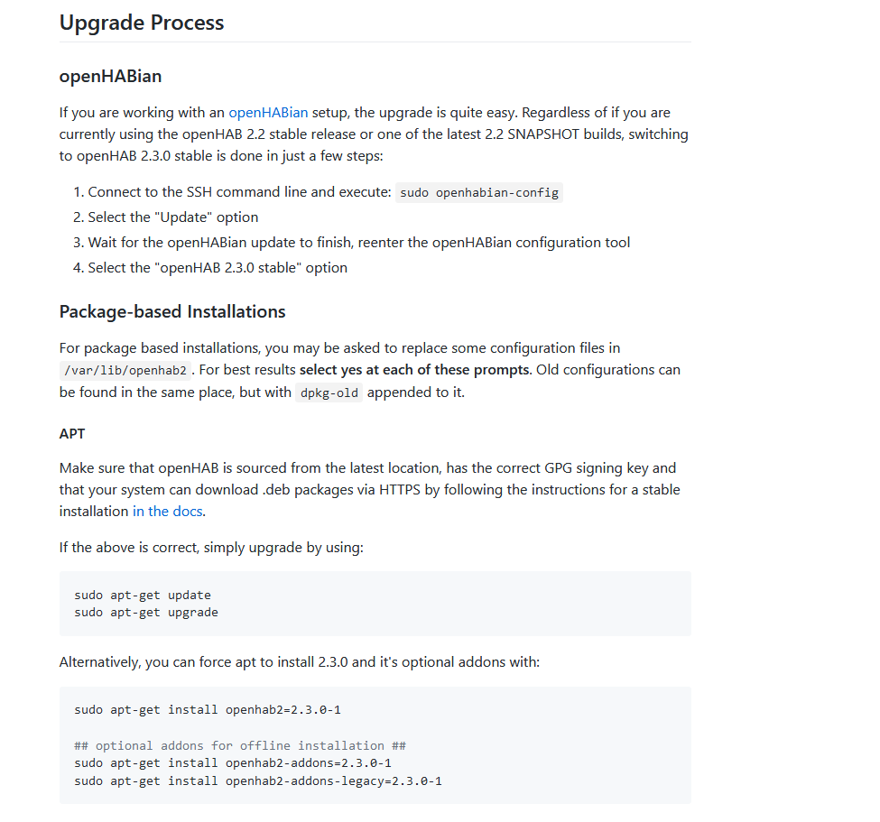

Looks like it’s already been added to the database. The 2.2 binding probably doesn’t have it included though. I think if you switch the 2.3 snapshot, then you should find the device discovers correctly.
