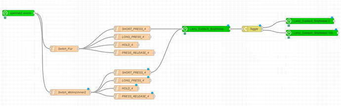

Okay, you’ve moved on quickly with that one.
Try dropping an openHAB2-get node between function and the switch.
Then set the switch to compare msg.payload.state
which will contain the value for the brightness (or whatever state the item has)
( FYI, all the Previous payload, as it was before it hit the Get node, is moved to msg.payload_in
