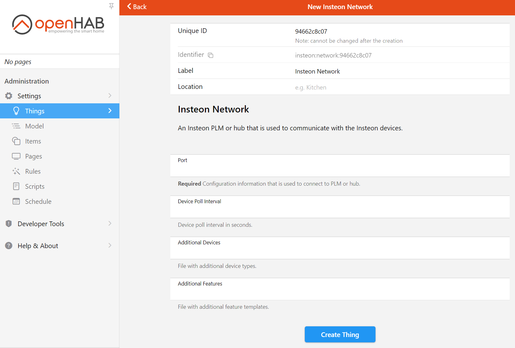

For the 2245, al you need to do is configure port with the following:
/hub2/my_user_name:my_password@192.168.1.100:25105
You will need to get the username and password from the bottom of the hub, and the IP address from your router.
Once you have correctly configured the hub, it will download the devices from the database on the hub and put them in the inbox. Then you can add the devices, but you will need to know the device type as described in the insteon binding documentation.

Using the openhab UI, go to settings->things and press the + button in the lower right hand corner. Then select Insteon Binding->Insteon Network. You should see this page:
Port is where you enter the /hub2/… from above. As for IP address, I have no idea why it’s using a private ip address instead of a dynamic one from your router.

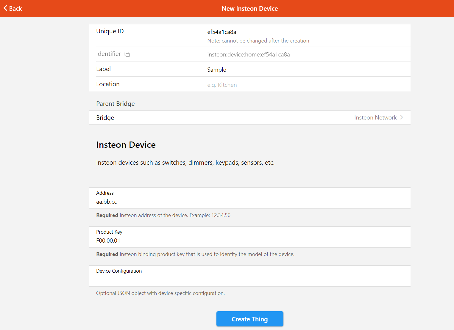

Now that I see 39 Things in my Inbox, how do I know what switch, outlet, Fanlinc, etc. each device is?
You’ll need to look at each switch, outlet, etc to get the address off of the device. It’s a hexadecimal number in the format aa.bb.cc. Then find the thing in the inbox with the same hexadecimal numbers without the ‘.’ and assign the appropriate product key and then press the “Create Thing” button. After that, the device should go online and the associated channels for the type will be created. Then you can link an item to the channel.

Can you show me the cod efor setting up a 2477D dimmer switch? With the example of one I can figure out the rest.
Thanks,
Wayne
It’s the first on in the list of product keys: F00.00.01 put this in the Product Key field:
If you haven’t previously documented the device id’s of the Insteon devices, you’ll need to get the device id off of the device so you know where it’s located and maybe the device type. If you don’t have many devices and don’t know it’s device ID, you can configure one with a device type and then see which one is controlled after it’s set up in openHAB.
