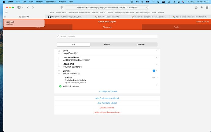

I’ve linked the Things to the proper Channels. As an example, I have an Insteon on/off Module (2635-222 product key) as a Thing that turns a light on/off. Under Channels for this Thing, it shows 4 items with one of them being a Switch. I have linked that Channel to the Thing. The light is turned off at the module. The Channel shows “Off”. If I go to the module and physically turn the module to the on position, then the Channel shows “On” and the light is in fact On, So it appears to be linked properly. What I’m trying to figure out is how to turn that light module on or off from openHAB vs. having to walk over to the module and physically turn it on or off. How do I do that?
None of what you have written suggests that you have done the above, although you may have. Things are not linked to Channels; Channels are linked to Items.
Perhaps share a screenshot with us?

Here’s a screenshot of the Space Sofa Lights Thing
Insteon has finally admitted that they’ve shut down due to insolvency.
Great! You have Items linked to Channels! Now I’d follow @JustinG advice on continuing to learn the concepts within openHAB.
So it looks correct what I’ve done?
Yep, if SpaceSofaLights_Switch state is changing from ON to OFF when you’re physically flicking the switch, then you seem to have the Things and Items setup correctly.
