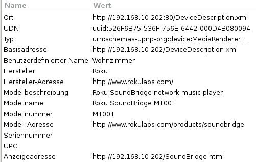

A Roku M1001

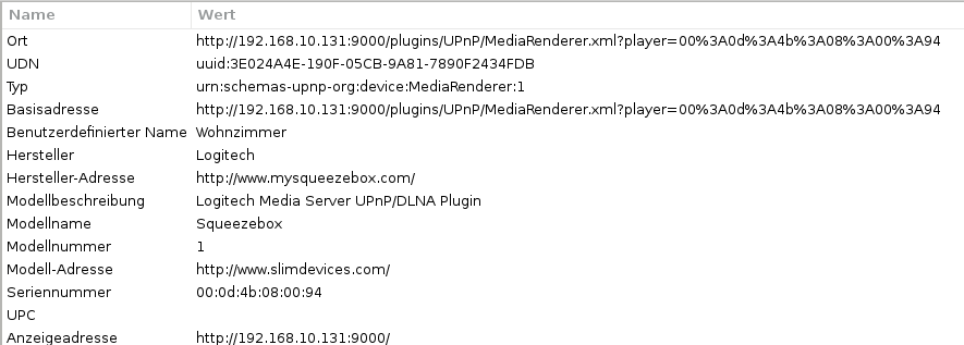

With squeezebox plugin:
Of course, this is through logitech media server
