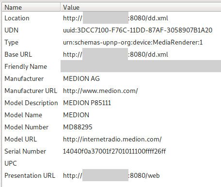

Hi!
Here’s my MEDION P85111 / MD88295:
Works when adding manually, but is not detected when scanning.

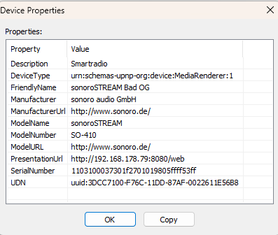

Sonoro Stream Player works for me with the binding
