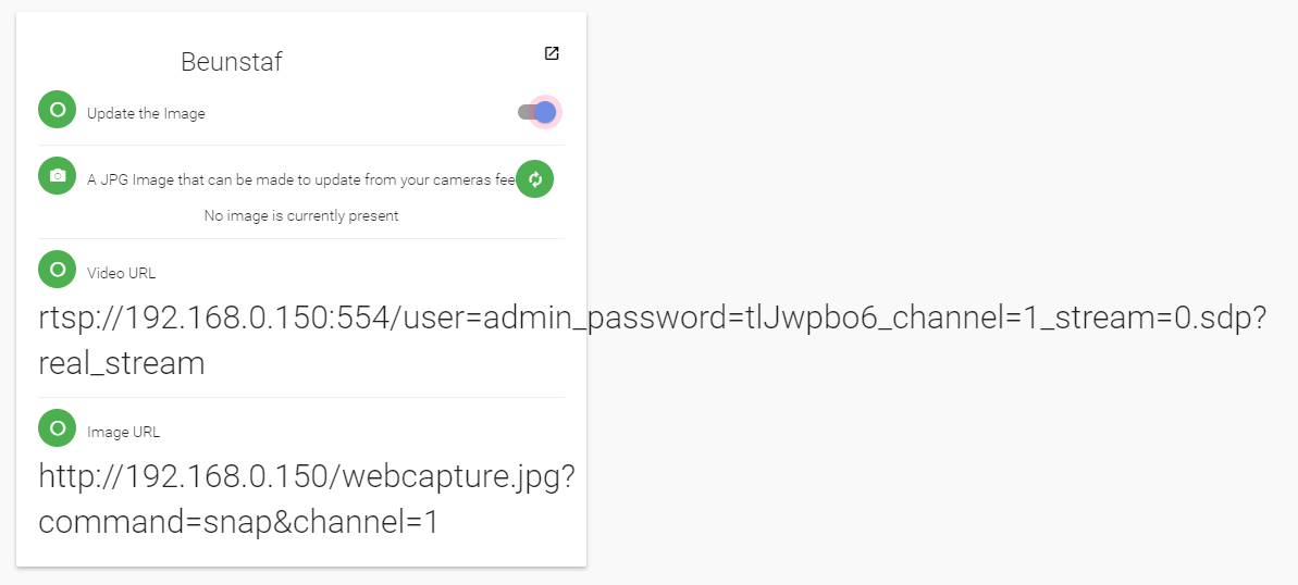

Hi Matt,
Maybe this problem has been noticed before, but i cant seem to get a good connection to my IPcam.
I added the binding and my camera as a thing. (status is “online”)
When i go to paper ui, I get the folowing:
Can you help me out? My goal is to get the feed in HabPanel.
Thanks,
Tom
Can you send me the debug log output please so I can take a look?

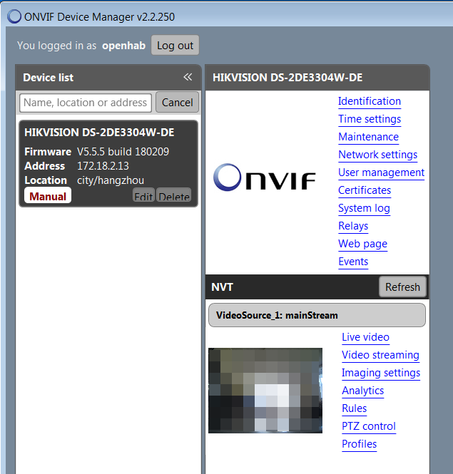

@matt1 Does the PTZ on HIK cameras work?
I have in the field videourl shows now this error
2018-05-30_13-51-04
I have no idea as I don’t own one. The ptz feature is done by onvif so it should work in any brand camera that has it implemented. The message is telling u onvif did not complete all the way through on your camera. Perhaps u have the wrong port selected or onvif is turned off by default in HIKVISION cameras.

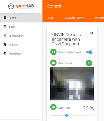

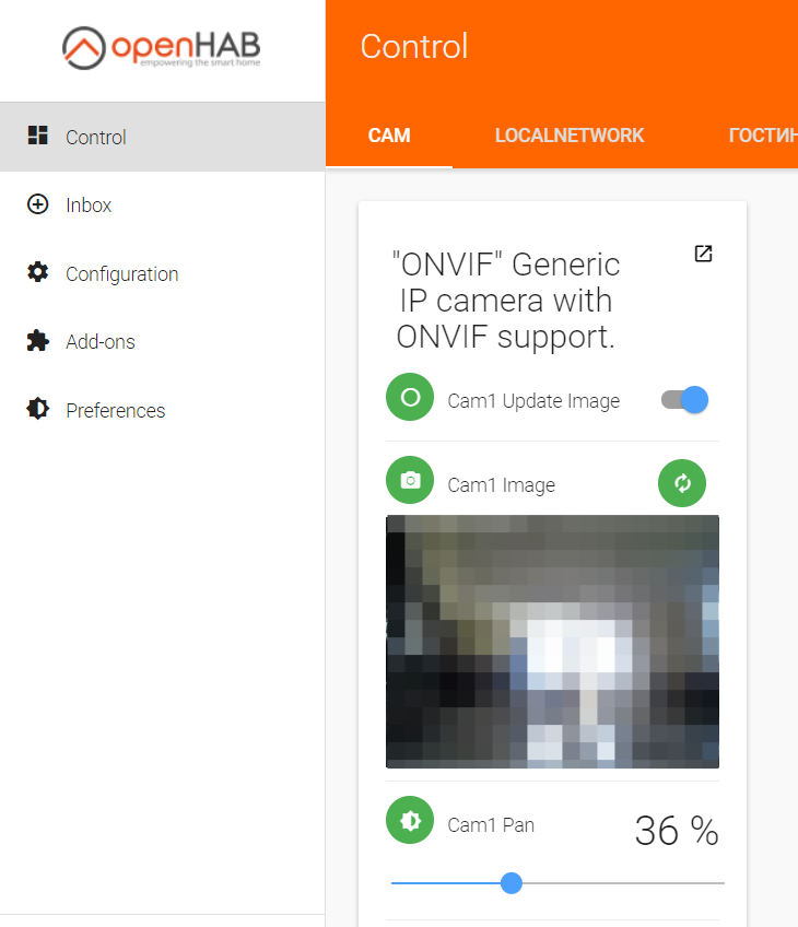

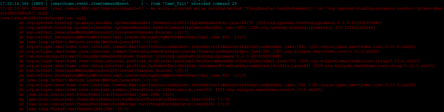

@matt onvif works.
Got a picture.
Tried to change thing for “Onvif generic” On it as there is a camera.
When trying to control PTZ in logs the following.
When thing “Hikvision” in the logs is the same error.

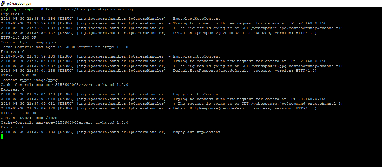

Hi Matt,
Sorry it took me so long.
That’s the snapshot. Is this what you meant?
Thx.
more info from the log:

with http thing:
2018-05-31 00:03:41.444 [DEBUG] [ing.ipcamera.handler.IpCameraHandler] - Getting configuration to initialize a new IP Camera at IP 192.168.0.32
2018-05-31 00:03:41.471 [DEBUG] [ing.ipcamera.handler.IpCameraHandler] - Camera at 192.168.0.32 has a snapshot address of:http://192.168.0.32:13439/snapshot.cgi?user=admin&pwd=pwd:
2018-05-31 00:03:41.475 [DEBUG] [ing.ipcamera.handler.IpCameraHandler] - Trying to connect with new request for camera at IP:192.168.0.32
2018-05-31 00:03:41.506 [DEBUG] [ing.ipcamera.handler.IpCameraHandler] - + The request is going to be GET:/snapshot.cgi?user=admin&pwd=pwd:
2018-05-31 00:03:41.539 [DEBUG] [ing.ipcamera.handler.IpCameraHandler] - DefaultHttpResponse(decodeResult: failure(java.lang.IllegalArgumentException: a header name cannot contain the foll$
HTTP/1.1 200 OK
Server: GoaHead
