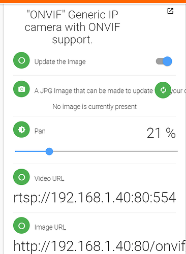

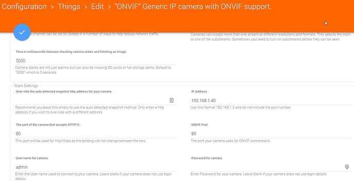

thanks for your answer

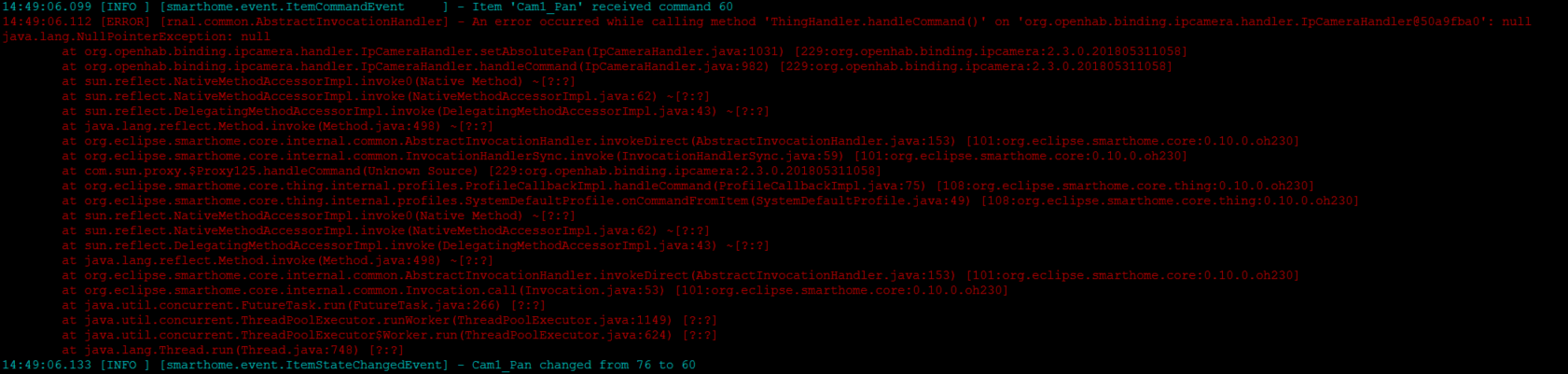

PTZ works well in onvif device manager.
i can add the cam and it;s online but it do not work
2018-05-31 03:15:38.291 [ome.event.ItemCommandEvent] - Item 'ONVIFGenericIPCameraWithONVIFSupport_Pan' received command 48
2018-05-31 03:15:38.300 [ERROR] [nal.common.AbstractInvocationHandler] - An error occurred while calling method 'ThingHandler.handleCommand()' on 'org.openhab.binding.ipcamera.handler.IpCameraHandler@10f8329': null
	at org.openhab.binding.ipcamera.handler.IpCameraHandler.setAbsolutePan(IpCameraHandler.java:927) [80:org.openhab.binding.ipcamera:2.3.0.201805252336]
	at org.openhab.binding.ipcamera.handler.IpCameraHandler.handleCommand(IpCameraHandler.java:878) [80:org.openhab.binding.ipcamera:2.3.0.201805252336]
	at sun.reflect.NativeMethodAccessorImpl.invoke0(Native Method) ~[?:?]
	at sun.reflect.NativeMethodAccessorImpl.invoke(NativeMethodAccessorImpl.java:62) ~[?:?]
	at sun.reflect.DelegatingMethodAccessorImpl.invoke(DelegatingMethodAccessorImpl.java:43) ~[?:?]
	at java.lang.reflect.Method.invoke(Method.java:498) ~[?:?]
	at org.eclipse.smarthome.core.internal.common.AbstractInvocationHandler.invokeDirect(AbstractInvocationHandler.java:153) [106:org.eclipse.smarthome.core:0.10.0.oh230]
	at org.eclipse.smarthome.core.internal.common.InvocationHandlerSync.invoke(InvocationHandlerSync.java:59) [106:org.eclipse.smarthome.core:0.10.0.oh230]
	at com.sun.proxy.$Proxy180.handleCommand(Unknown Source) [80:org.openhab.binding.ipcamera:2.3.0.201805252336]
	at org.eclipse.smarthome.core.thing.internal.profiles.ProfileCallbackImpl.handleCommand(ProfileCallbackImpl.java:75) [113:org.eclipse.smarthome.core.thing:0.10.0.oh230]
	at org.eclipse.smarthome.core.thing.internal.profiles.SystemDefaultProfile.onCommandFromItem(SystemDefaultProfile.java:49) [113:org.eclipse.smarthome.core.thing:0.10.0.oh230]
	at org.eclipse.smarthome.core.internal.common.Invocation.call(Invocation.java:53) [106:org.eclipse.smarthome.core:0.10.0.oh230]
could you kindly advise?

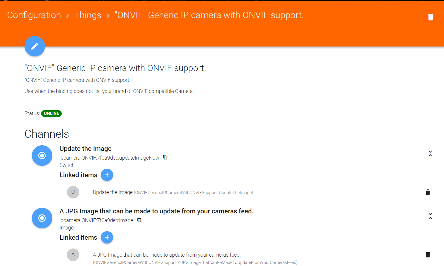

Tried with both HIK and Onvif Generic
I got the error again:

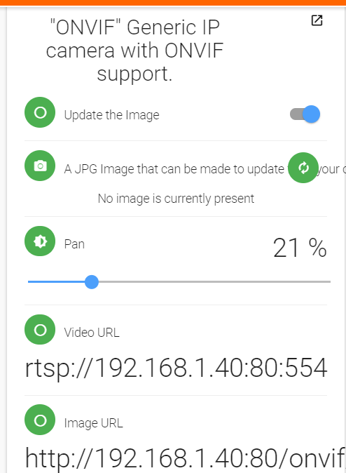

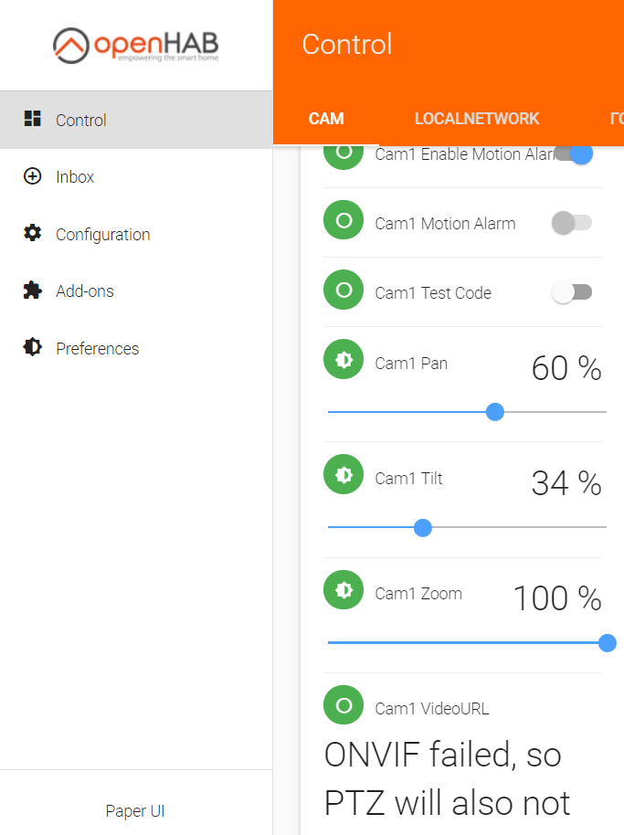

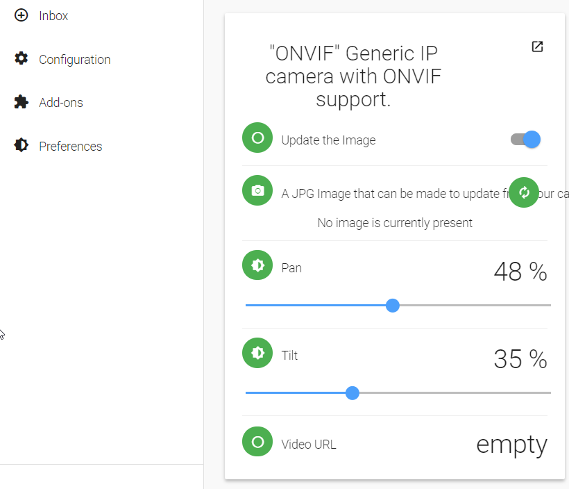

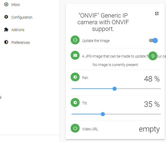

Do u have all three controls linked? Pan tilt and zoom are they all linked and able to be moved in paper ui? Also did you test absolute movement in onvif device manager as there are three types of movement with onvif.
Yes, I have all three elements tied.
At Pan tilt shows in the console an error that I cited above.
When I do zoom I have the following shows:

Ok, now no errors, the image is displayed! :slight_smile:

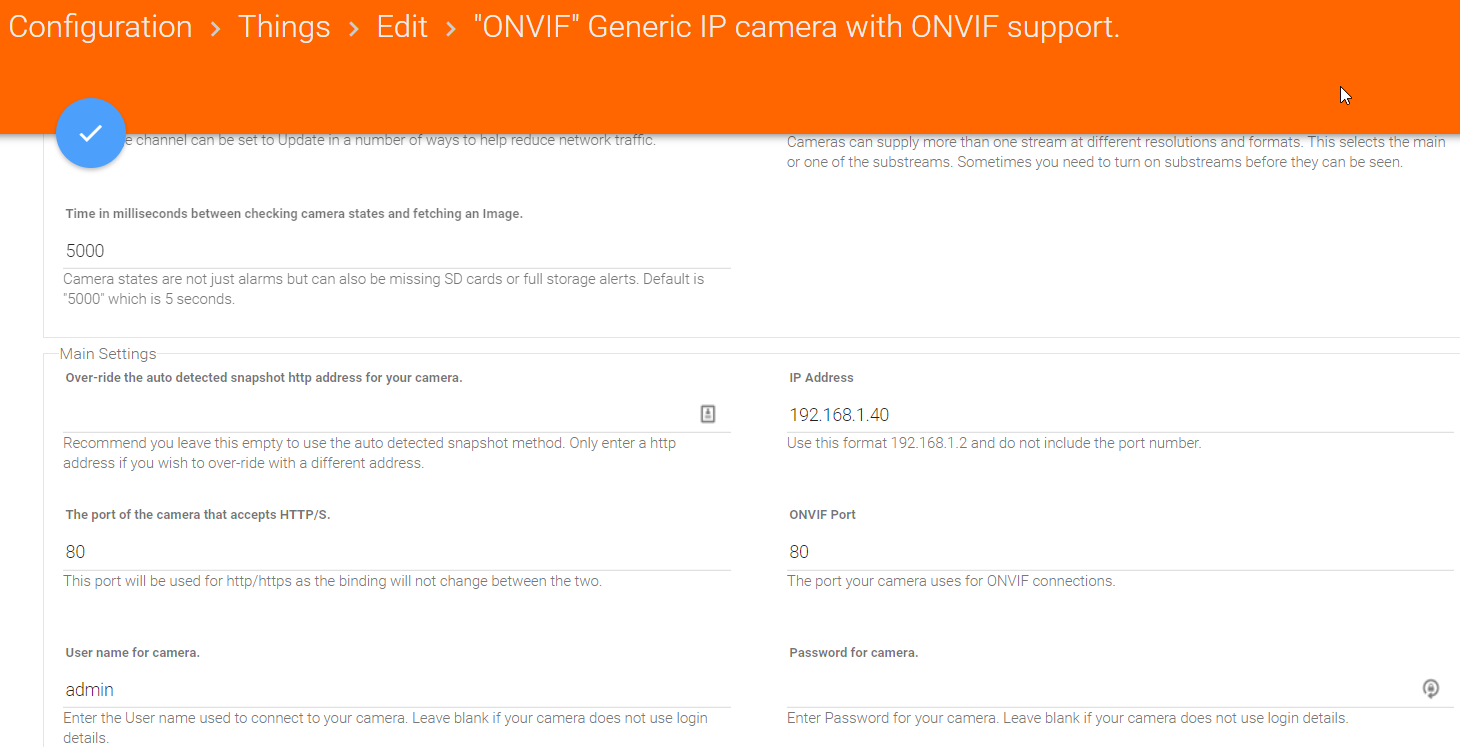

@tnemrap
Try this latest build, also please make sure you have the " Enable Hikvision-CGI" box ticked which is found on the same page as enabling ONVIF. I now own 3 HIKVISION cameras which are working for me after ticking that box. Also these cameras are far slower to respond to requests for a snapshot and if your network is busy with traffic it may have caused issues

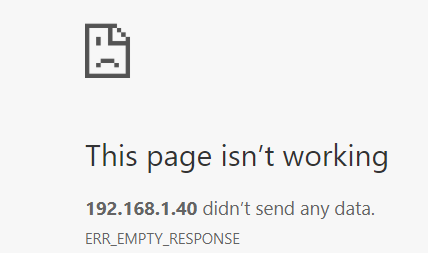

i have tried and the camera but it do not work
2018-06-03 21:36:01.250 [ERROR] [ing.ipcamera.handler.IpCameraHandler] - Can not connect to the camera at 192.168.1.40:80 check your network for issues.

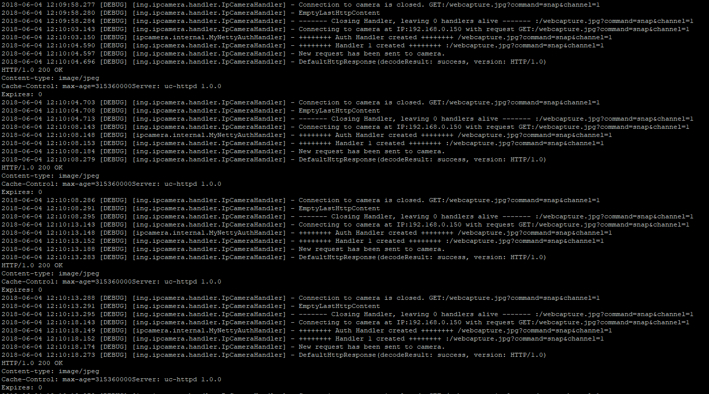

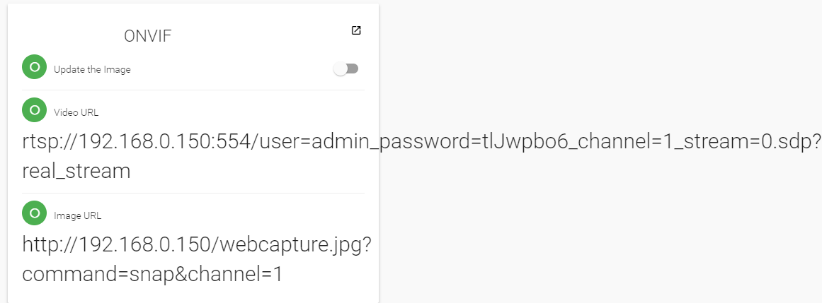

After enabling the debug log
2018-06-04 10:57:08.518 [DEBUG] [ing.ipcamera.handler.IpCameraHandler] - Getting configuration to initialize a new IP Camera at IP 192.168.1.40
2018-06-04 10:57:08.523 [INFO ] [ing.ipcamera.handler.IpCameraHandler] - About to connect to the IP Camera using the ONVIF PORT at IP:192.168.1.40:80
2018-06-04 10:57:16.560 [INFO ] [ing.ipcamera.handler.IpCameraHandler] - Fetching the number of Media Profile this camera supports.
2018-06-04 10:57:19.559 [INFO ] [ing.ipcamera.handler.IpCameraHandler] - Checking the selected Media Profile is a valid number.
2018-06-04 10:57:19.561 [INFO ] [ing.ipcamera.handler.IpCameraHandler] - Fetching a Token for the selected Media Profile.
2018-06-04 10:57:19.564 [INFO ] [ing.ipcamera.handler.IpCameraHandler] - Auto fetching the snapshot URL for the selected Media Profile.
2018-06-04 10:57:22.487 [DEBUG] [ing.ipcamera.handler.IpCameraHandler] - About to fetch some information about the Media Profiles from the camera
2018-06-04 10:57:22.490 [DEBUG] [ing.ipcamera.handler.IpCameraHandler] - ********************* Media Profile 0 details reported by camera at IP:192.168.1.40 *********************
2018-06-04 10:57:22.492 [DEBUG] [ing.ipcamera.handler.IpCameraHandler] - Camera will use this Media Profile unless you change it in the binding by pressing on the pencil icon in PaperUI.
2018-06-04 10:57:22.494 [DEBUG] [ing.ipcamera.handler.IpCameraHandler] - Media Profile 0 is named:VideoEncoder_1
2018-06-04 10:57:22.496 [DEBUG] [ing.ipcamera.handler.IpCameraHandler] - Media Profile 0 uses video encoder	:H_264
2018-06-04 10:57:22.498 [DEBUG] [ing.ipcamera.handler.IpCameraHandler] - Media Profile 0 uses video quality	:10.0
2018-06-04 10:57:22.500 [DEBUG] [ing.ipcamera.handler.IpCameraHandler] - Media Profile 0 uses video resoltion	:1280 x 720
2018-06-04 10:57:22.502 [DEBUG] [ing.ipcamera.handler.IpCameraHandler] - Media Profile 0 uses video bitrate	:0
2018-06-04 10:57:22.505 [DEBUG] [ing.ipcamera.handler.IpCameraHandler] - ********************* Media Profile 1 details reported by camera at IP:192.168.1.40 *********************
2018-06-04 10:57:22.507 [DEBUG] [ing.ipcamera.handler.IpCameraHandler] - Media Profile 1 is named:VideoEncoder_2
2018-06-04 10:57:22.509 [DEBUG] [ing.ipcamera.handler.IpCameraHandler] - Media Profile 1 uses video encoder	:H_264
2018-06-04 10:57:22.512 [DEBUG] [ing.ipcamera.handler.IpCameraHandler] - Media Profile 1 uses video quality	:10.0
2018-06-04 10:57:22.514 [DEBUG] [ing.ipcamera.handler.IpCameraHandler] - Media Profile 1 uses video resoltion	:640 x 320
2018-06-04 10:57:22.517 [DEBUG] [ing.ipcamera.handler.IpCameraHandler] - Media Profile 1 uses video bitrate	:0
2018-06-04 10:57:22.519 [INFO ] [ing.ipcamera.handler.IpCameraHandler] - About to interrogate the camera to see if it supports PTZ.
2018-06-04 10:57:33.201 [ERROR] [ing.ipcamera.handler.IpCameraHandler] - NPE occured when trying to connect to the camera with ONVIF
2018-06-04 10:57:33.532 [DEBUG] [ing.ipcamera.handler.IpCameraHandler] - Connecting to camera at IP:192.168.1.40 with request GET:/onvif/snapshot
2018-06-04 10:57:33.912 [DEBUG] [ipcamera.internal.MyNettyAuthHandler] - ++++++++ Auth Handler created ++++++++ /onvif/snapshot
2018-06-04 10:57:33.926 [DEBUG] [ing.ipcamera.handler.IpCameraHandler] - ++++++++ Handler 1 created ++++++++ :/onvif/snapshot
2018-06-04 10:57:34.039 [DEBUG] [ing.ipcamera.handler.IpCameraHandler] - New request has been sent to camera.
2018-06-04 10:57:34.063 [DEBUG] [ing.ipcamera.handler.IpCameraHandler] - Connection to camera is closed. GET:/onvif/snapshot
2018-06-04 10:57:34.068 [DEBUG] [ing.ipcamera.handler.IpCameraHandler] - ------- Closing Handler, leaving 0 handlers alive ------- :/onvif/snapshot
getting a loop of “New request has been sent to camera.”
what should be the http port or https port ?
Thanks for your help
Hi Matt,
updated the binding but still have the same issue. My debug log:
PaperUI:
And Habpanel:
Thx again
@TomBeerten
Your camera appears to not send any jpeg data before the “lasthttpcontent” which triggers the binding to close the connection. Can you check the link shown in the Image URL works if you manually enter it into a browser?
@nakh_Home
Next build will have more logging in the area needed to narrow the PTZ issue down and should handle the issue smoother.
I suspect you have a second issue as this line seems strange..
It should be higher than 0.
Try the link in any brower to check it works. You need to find a link that works in a browser if this one does not.
http://192.168.1.40/onvif/snapshot
i am trying to add this camera Y203S
