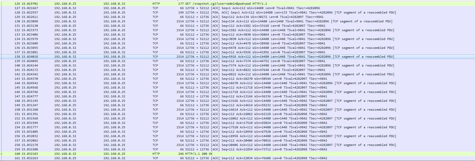

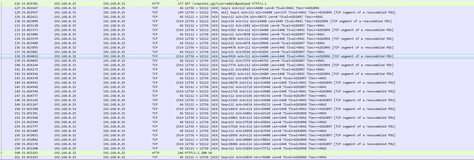

thanks for the tip with traffic pickup. I recorder the traffic between my devices (192.168.0.25 is the openhab host and 192.168.0.32 is the cam). The pcap session is attached:
https://ufile.io/ftp21
I hoped I would be able to spot the violation, but I am not. Are you able to have a look?
The session looks ok, the host acknowledges the http image transfer with ok status, I cant see where the error is:

I may have noticed something but I am no expert and this may not be the issue, but it makes sense…
My camera and others that people have posted in this thread have headers that look like this.
HTTP/1.1 200 OK
Content-type: text/plain;charset=utf-8
CONNECTION: close
CONTENT-LENGTH: 18
Another camera of mine
HTTP/1.1 401 Unauthorized
Date: Wed, 06 Jun 2018 19:57:00 GMT
Server: webserver
Content-Length: 178
Content-Type: text/html
Connection: keep-alive
Keep-Alive: timeout=10, max=99
Your camera looks like this.
HTTP/1.1 200 OK
Server: GoaHead
Tue, 12 Jun 2012 01:56:34 GMT
Content-Type:image/jpeg
Content-Length:21003
Connection: close
The first thing I notice is there is no space after the ‘:’ delimiter in the header which may be because your camera creates a header (or netty wrongly IDs it due to a bug) called “Content-Length:21003” instead of a header called “Content-Length” with a value of “21003”
Edit: It could also be the date and time being detected as a header and it has illegal characters in it. I would need to double check it was not an error on my half when I cut and pasted from your logs but the Date: header looks like it breaks convention.
If your camera works in multiple browsers and only fails with this binding then I would report this as a possible bug here. It is an active project, and I believe minecraft uses the library.

Hi Matt,
well-spotted. I tested my cam in chrome, safari, firefox and ie - and it works in all of them. I would appreciate if you could report it.

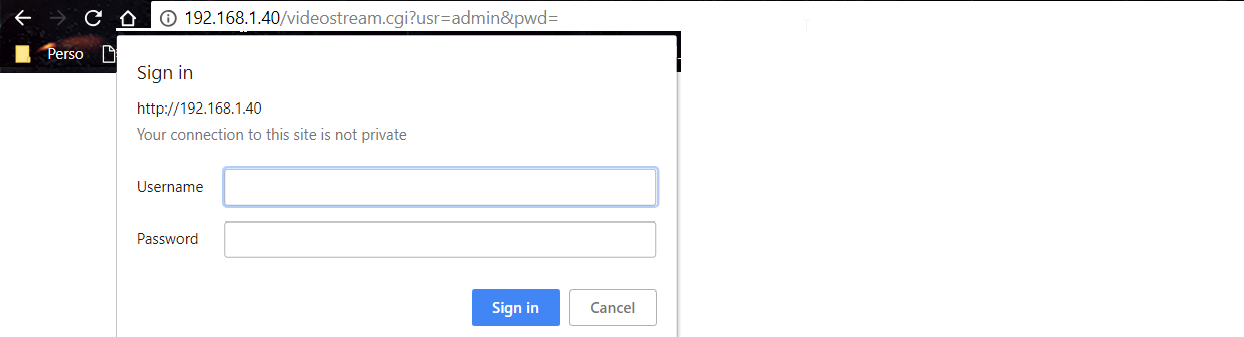

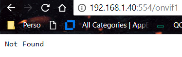

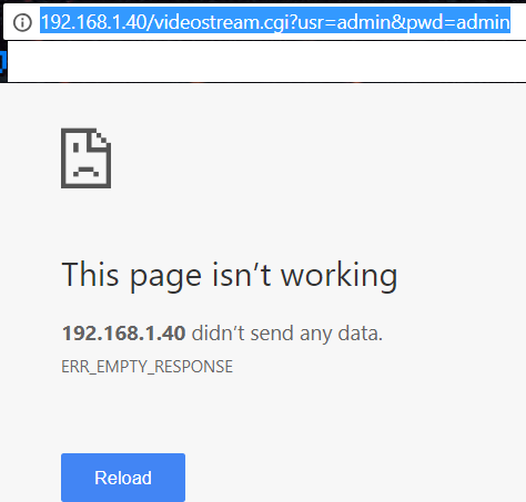

try the link below in any browser, just put your ip user and passvord
http://[IP]/videostream.cgi?usr=[USERNAME]&pwd=[PASSWORD]
or
http://IP ADDRESS:554/onvif1
Matt,
Searched all over google, but cant find one that works. Its an IP-cam from china, do you have any clue or hints?
i have tried admin/blank (which works for rtsp://192.168.1.40:8001/0/avN in VLC)
i have also tried admin/admin
in every cases, i am getting :slight_smile:
