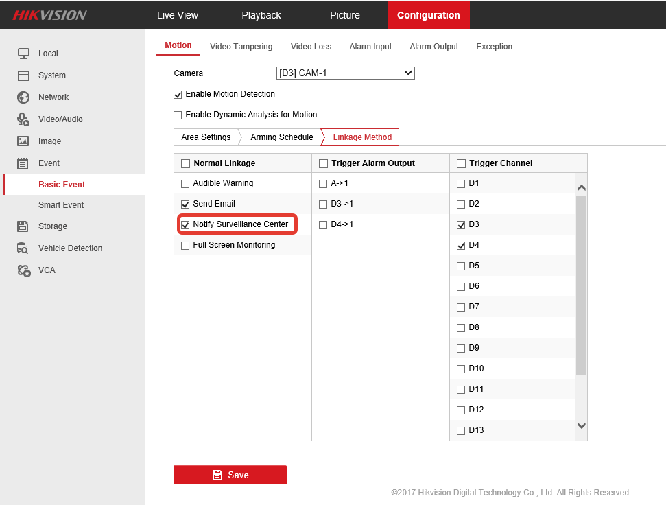

Event does not work when triggered
NVR does not send to stream /ISAPI/Event/notification/alertStream trigger events :frowning:
stream It works !!!
It is necessary in the notification settings to put a tick next to “Notify Surveillance Center” and then alerts will appear in the stream. :+1:
in stream:

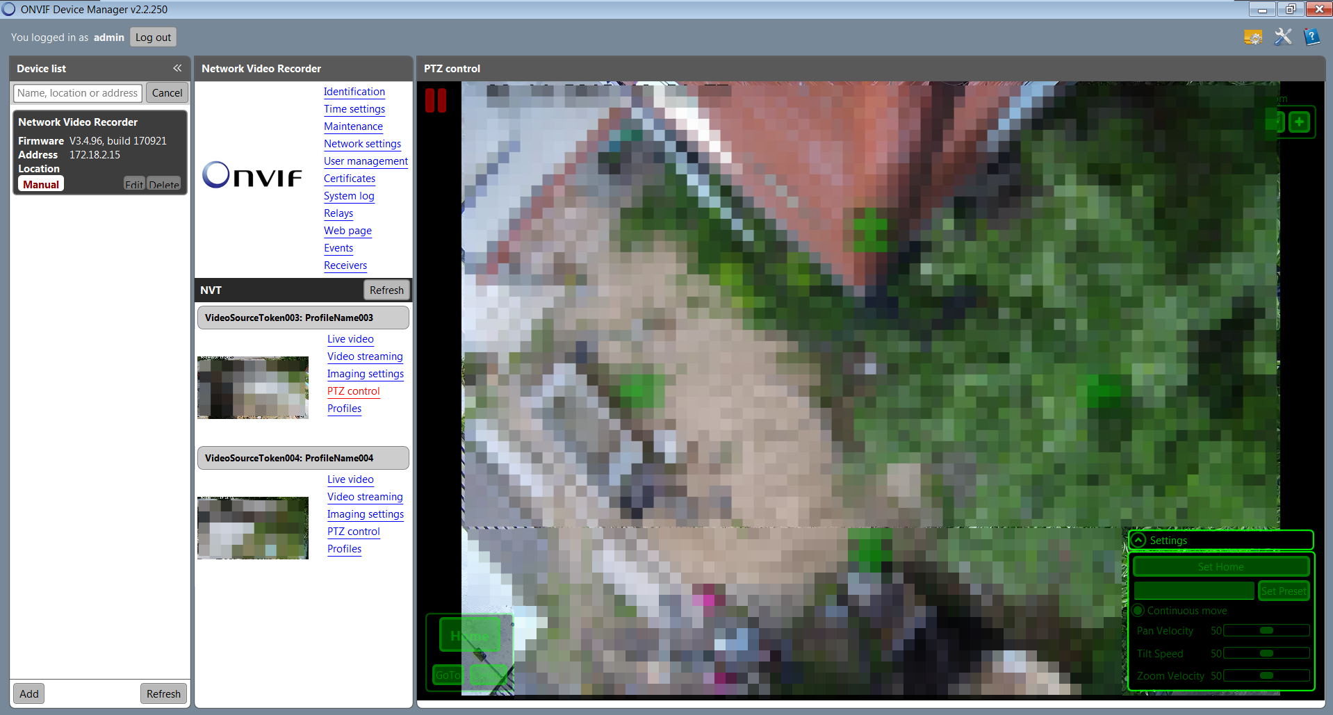

@matt1 In onvif device manager I have PTZ camera control, I also have an image via onvif.
And in binding writes that ONVIF failed, PTZ may not work.
In logs which I sent you for some reason too writes that " Camera is reporting that it does NOT support Absolute PTZ controls via ONVIF"
@Melkor
What symptoms do you see? what does not work, or does everything work and it is just the log? as this may give me clues where to look.
I took a look at your logs and it appears everything is working fine as the Handler number is not increasing over the time frame your logs show. My guess is the fault occurred when the camera was connecting, can you provide some TRACE level log output when you see the handler number grow from 1 and is increasing please? The foscam cameras only support 4 connections and this may result from the binding having more than this when openhab calls the REFRESH on all the channels when the camera comes online. Try with the latest build and reboot your server and camera to reset things. Your camera was showing strange output where the <> characters were missing around the XML output. If this continues I may need to implement some kind of connection limiter to keep it under 4 at all times with foscam, the output you show has only 2 connections/channels in use.
@toroid
If you can send debug output when you move a PTZ control I can take a look. If you don’t move a control and capture what happens I can not do much as all my tests are showing it works even when a camera replies with null.
@matt1 Yes, camera binding is working well, it’s only in the logs. But I am in a period of time i am trying to reduce the logging as much as possible for the sd related wear out. This logging starts a while after i restart the server. ANd once in a while the number increase by one. I looked at the incrasing moment and channel one was not closed. The strange log was my fault as I tried to apply fences twice. I will try to catch the moment in which the channel number are increasing. If it is somehow usefull the last build without this logging was the one of 8 june
Today I checked the work of PTZ on NVR in onvif device manager.
PTZ works. The screen shot below.
When you change pan, tilt and zoom in things in the logs do not see any action on the part of binding on these commands.
Detailed log sent to e-mail

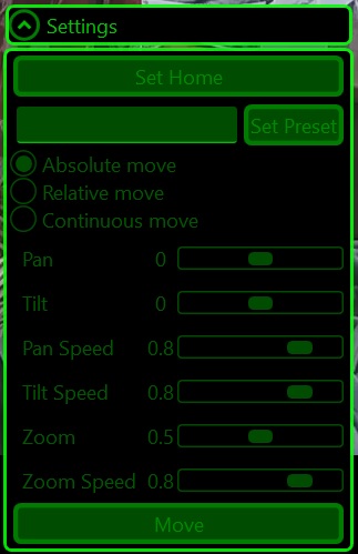

Your camera only supports CONTINUOUS MOVE and the binding only does ABSOLUTE MOVE. The binding is working fine and it tells you in the log that your camera does not support absolute move so there is no bug. I will change the text that causes confusion…
There are 3 types of movement and my Amcrest does all three types. See a picture of what my settings in the bottom right looks like. A user of the binding earlier mentioned they may look at adding support for the continuous move.
Can you test if the presets work for you? Presets would be easier to implement and solves many issues that stem from slow/bad/lag network connections. There is another way to implement continuous in a sudo relative move way that could also work but it may not be as useful as just presets.
@matt1 by the way since this morning there were no more logs with the latest build. Thanks!
@matt1 You are right, the NVR camera does not support absolute movement.
If you connect directly to the camera, the item with absolute movement appears.
Now I’ll set up binding to connect to the camera directly and check the PTZ.
The preset list is available only when you connect the camera directly. If through NVR it too is not present.
