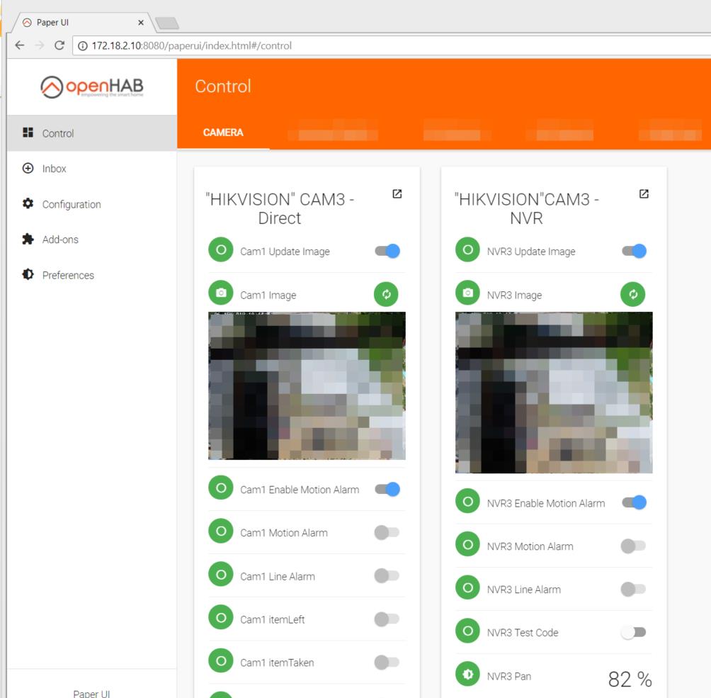

Working is different to it appearing. Does the ONVIF device manager actually move your camera with ABSOLUTE move selected? That program does not share any code with my binding, so if it fails to move in that program then it will confirm your issue is with your camera. In this case your only option is to upgrade the old hacked firmware to a newer hacked version, or to use presets instead if they work.
The same goes for …
Does this mean it actually moves the camera? My camera can be moved with the presets and the home button.
When you connect the camera directly to OFDM and select absolute move everything works.
In the latest version of binding, when you connect the camera directly, it does not even show a picture.
When you connect binding to nvr picture from the camera is, alarm works.
If you look at the last log sent there from 15:40:56 there are some errors.

Tried version binding until 31.05. When connected directly to the camera, the pictures could not be seen.
With NVR picture show all.
I don’t know what I did, but the picture came out. :slight_smile:
Understood. The picture can not be obtained using the username and password for onvif.
It turns out that the binding hik does not work with onvif :frowning:

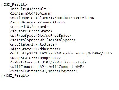

Try this link in any browser and let me know what the camera sends as a reply when you have movement.
http://IPaddress/cgi-bin/CGIProxy.fcgi?cmd=getDevState&usr=username&pwd=password
Yes that is intentional, the log will not get filled up with useless lines when things are going well. If you want to see what is happening see the first post of this thread on how to enable TRACE logging. You will then see what is sent to the camera and what the camera replies with.
This error occurs when the camera does not support a ONVIF method, the TRACE log will tell you what the binding was sending right before this error happened. This will not be connected to not getting alarm alerts. Try updating the firmware for your camera to the latest.

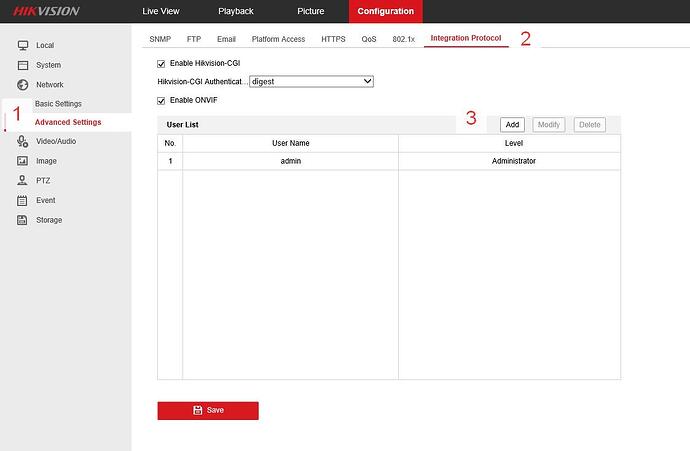

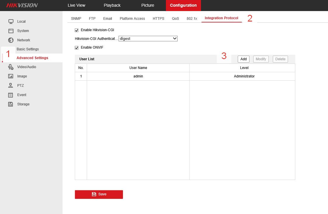

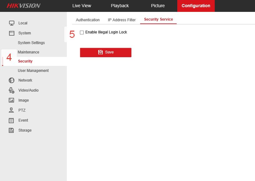

Got it working, but now it constantly requires for a password. I enter the password, it works for 30seconds and then it starts to spam the password requirement.
See first post for how to enable onvif and the api, HIKVISION has them disabled by default.

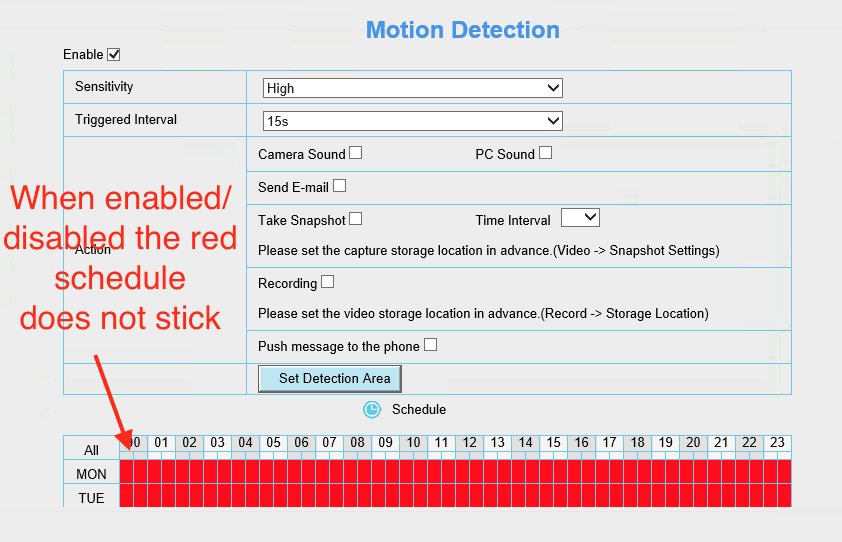

Matt, I realized something…
The binding through OH ( Enabled/Disable the motion alarm ) clears out the red highlighted scheduling. I need to have some red in there in order for the actual motion notification to be enabled.
I figure I can keep it enabled at all times (with all red highlighting ) and not use the “enable/disable” binding and just have another switch in OH that continues the notification to me when I have it enabled.

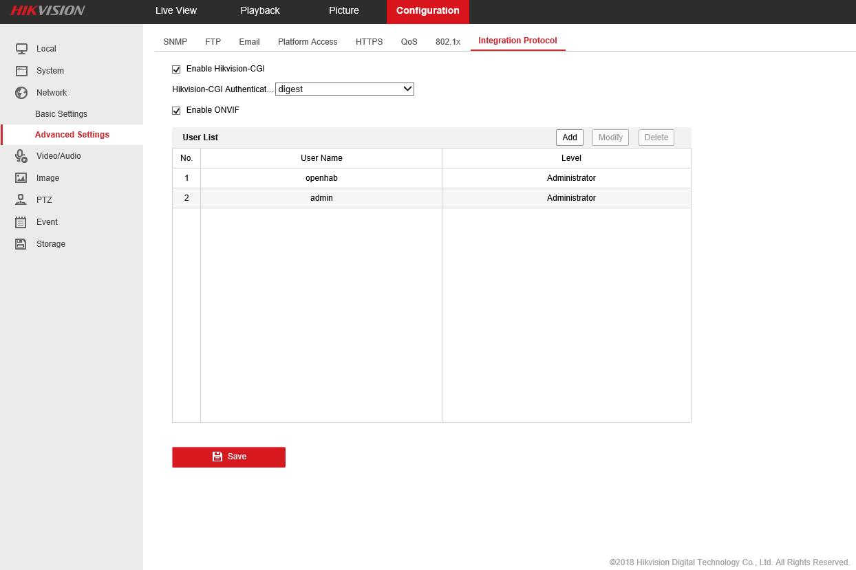

turn on onvif and hikvision cgi
add admin user and password for onvif
turn off illegal login lock
It still requires for the password after sometime
Connecting it to the camera not to the dvr fixed the issue

@chaderick9
The latest build will enabling the motion alarm with one of these, can you see if it goes all red? If not you can use these to experiment with.
/cgi-bin/CGIProxy.fcgi?cmd=setMotionDetectConfig&isEnable=1&schedule0=1023&schedule1=1023&schedule2=1023&schedule3=1023&schedule4=1023&schedule5=1023&schedule6=1023&usr=username&pwd=password
/cgi-bin/CGIProxy.fcgi?cmd=setMotionDetectConfig1&isEnable=1&schedule0=281474976710655&schedule1=281474976710655&schedule2=281474976710655&schedule3=281474976710655&schedule4=281474976710655&schedule5=281474976710655&schedule6=281474976710655&usr=username&pwd=password
