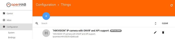

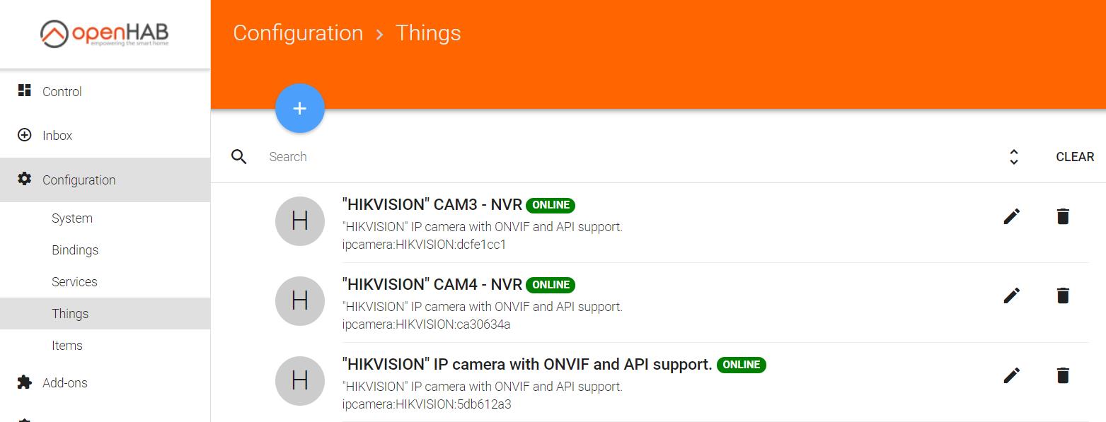

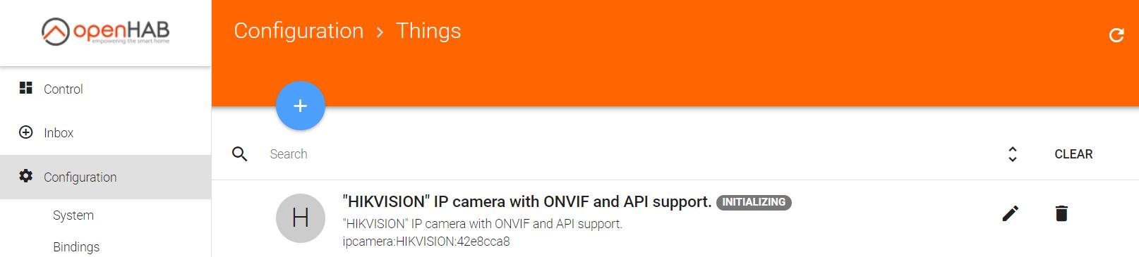

In the latest version, the same error on onvif is caused when connecting the camera directly.
And no picture from the camera.
The status of things - provisioning. In early versions of binding the status was initialized and there was a picture from the camera (though ptz did not work)
Through NVR everything works (except PTZ) as binding does not support such type of control (countur)
@toroid

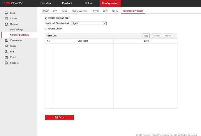

I own a Hikvision and have tested it extensively direct to openhab with no NVR as I do not own one. Please delete the camera, re-add it and check your settings. Recent builds have different channels so you must delete and re-add if you do not use TEXTUAL CONFIG. The error as I have mentioned before is your camera not replying when asked about PTZ, it should not stop the camera working. The error should disable the PTZ from working, but it is not related to your picture issue. Check the setting are correct and the NVR input channel is set to 1 for cameras not connected to a NVR.
I turned off onvif on the camera (still it does not work as it should) and things immediately changed to online.
And the picture also appeared

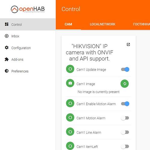

Also, I just realized that the Motion Alarm state through OH never changes when motion is detected.
Earlier you had asked me to check the value at:: /cgi-bin/CGIProxy.fcgi?cmd=getDevState
and param motionDetectAlarms value never changed from 1 (no alarm). Now with your help and the troubleshooting that has been done, with the proper setting in my cameras configuration, that value does change from 1 to 2 (detect alarm) when motion is detected.
Am I misconfiguring OH? I also have OH configured to “Update the image during motion alarm” and the image does not update.

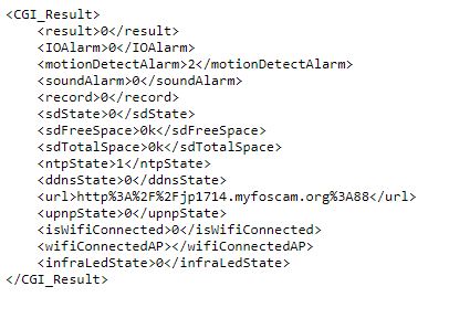

My formatting on my last comment was misleading. The camera does not use “motionDetectAlarms”, it is the same as the other cameras and uses, “motionDetectAlarm”
I am still not getting motion triggered notifications for some reason though, despite the motionDetectAlarm value changing from 1 to 2.

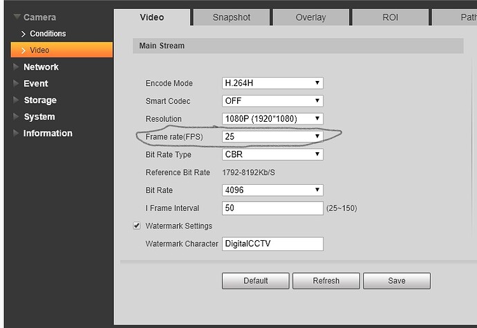

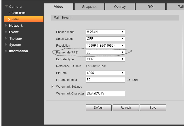

I installed this binding using “DAHUA” ip camera .. It works well but It is very Slow to update The image.
And what does ths log mean?
2018-06-26 00:14:53.203 [WARN ] [ing.ipcamera.handler.IpCameraHandler] - !!!! Alertstream was not running, Cleaning channels and then going to re-start it now.
Can you define slow? I see you have it set to update every second, is it not doing that? Cameras need a key frame to generate a snapshot from so the video settings can effect the snapshot ability.
That warning should happen when first connecting as it means the alarm checking was not running. If it continues in the logs then it will be an issue to look at. Dahua and hikvision both have the ability to open a single stream and keep it open so the camera can inform openhab a alarm is going off. If the stream is not staying open that warning occurs.
yes !
Do you mean this settings?
Thank you for the feedback it is greatly valued as I have not heard how it works on Dahua yet. I’m sorry but I am still unclear if your picture updates every second? If you think there is an issue then please create some trace log output and I can take a look. As I don’t own Dahua cameras I am very limited to what I can do without log files to show what is going on. First post of this thread explains how to change to trace log output.
The I frame setting try reducing that or play with all settings on that page. The hikvision cameras I have actually send 3 requests for a snapshot before the first request actually gets a picture. The compression also takes time on high resolution cameras so the binding needs to ask multiple times and that may not be happening on your camera, can’t tell without log output.

@matt1
Testing latest 2.3.0.201806250815
On my two Foscams C1 almost everything seems to work properly. Almost
What’s not working is pulling the state of enableMotionAlarm and enableAudioAlarm from the camera.
If I disable motion or audio alarm from the camera interface or app the channels are not updated.
the response from the camera is:
