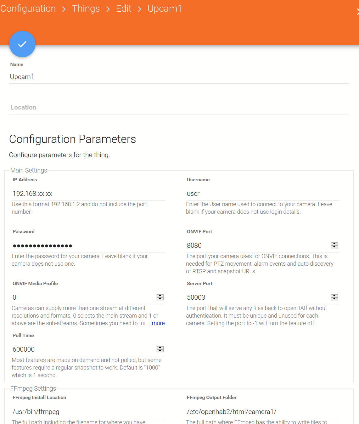

i have an issue with the events for the motion detection.
my openhab system:
Release = Raspbian GNU/Linux 10 (buster)
Kernel = Linux 5.4.83-v7l+
Platform = Raspberry Pi 4 Model B Rev 1.2 4GB / SSD
Updates = 0 apt updates available.
openHAB 2.5.11-1 (Release Build)
the IP-Camera is an UPCAM Tornado HD S (www.upcam.com)
After the installation of the IPCamera binding via PaperUI i was running discovery for this ONVIF-supported camera and the thing for the camera was created.
I have used the DEBUG level for logging of the ipcamera binding to fix some issues with the binding. I was able to fix most of them. I am still struggling with the motion detection.
There are a lot of entries every 5-20 second in the logging:

They are normal and come from ONVIF, do you have the cell motion channel linked or the normal motion channel?
So far i have seen theses events only in the logging. For test purpose i have linked both, but only the cell motion channel get updates
2021-01-17 14:36:15.477 [thome.event.ItemStateEvent] - Upcam1CellMotionAlarm updated to OFF
2021-01-17 14:36:27.643 [thome.event.ItemStateEvent] - Upcam1CellMotionAlarm updated to OFF
2021-01-17 14:36:33.732 [thome.event.ItemStateEvent] - Upcam1CellMotionAlarm updated to OFF
2021-01-17 14:36:43.918 [thome.event.ItemStateEvent] - Upcam1CellMotionAlarm updated to ON
2021-01-17 14:36:49.013 [thome.event.ItemStateEvent] - Upcam1CellMotionAlarm updated to ON
2021-01-17 14:37:01.232 [thome.event.ItemStateEvent] - Upcam1CellMotionAlarm updated to OFF
2021-01-17 14:37:07.313 [thome.event.ItemStateEvent] - Upcam1CellMotionAlarm updated to OFF
2021-01-17 14:37:13.422 [thome.event.ItemStateEvent] - Upcam1CellMotionAlarm updated to OFF
Is there any possibility to get rid of these unneccessary events (motion=false) or at least to reduce the frequency.
I always try to optimize a system and get rid of unneccessary actions.
You can filter the logs to remove them by adding lines to a cfg file. Search the forum for how. I’ll have a look at the code when I have spare time to see if it can be filtered at the binding level, but this will take some cpu and ram to do this, but I do understand it is annoying if the event log gets flooded with noise. Best to raise this as a git hub issue.

log-filtering is already in place, i have setup a solution where i can change the logging on the fly via an openhab sitemap and respective rules.
I was more thinking about a solution to avoid events comming from the ipcamera (in my case an UPCAM camera) to openhab, may be a filter in CreatePullPointSubscription could be used. I am not an expert in ONVIF but this is what i found in the ONVIF documentation.
