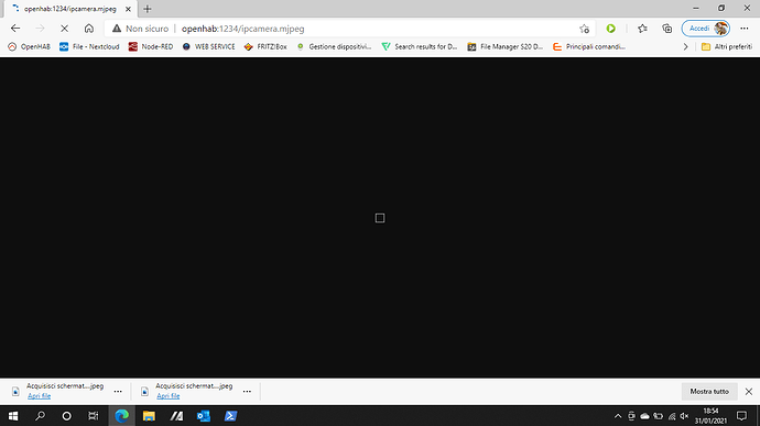

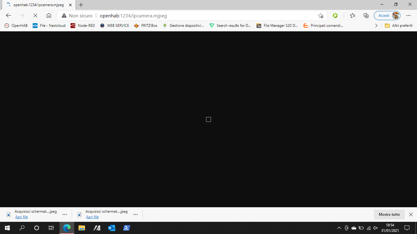

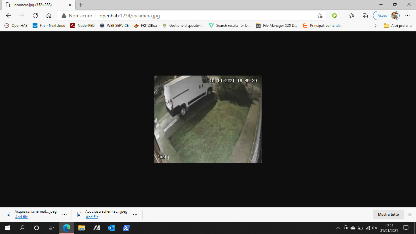

HI,
I have a problem that already occurred with openhab version 2 and now that I have upgraded to version 3, the problem persists.
My system is based on openhabian mounted on an RPI 4, and as video surveillance I have 6 cameras connected to a Dahua NVR.
I have installed Ipcamera binding and ffmpeg. Correctly configured the binding via ex paperui, I cannot correctly view the url on the web.
I am attaching a photo of the screenshot of my pc with the image captured correctly
and screenshot with videostream not working
Can someone help me?
