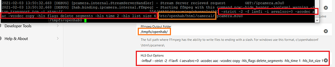

Thanks for binding - was having troubles with HLS on OH3 Pages, but latest update to 3.0.1 seems to have resolved it.
This has allowed me to play around a bit and notice a few potential issues:
  1. Whenever Thing settings are saved for a camera, the working folder for mmpeg cache files isn’t cleared. The main problem with this is that the HLS feed shows the outdated cache files before stopping. This requires manually clearing the folder down before it works again.
  2. Saving the camera Thing after making changes doesn’t seem to apply changes as expected. What I am seeing is that the binding does some sort of reload to itself or the camera stream (HLS stream stops if it is currently running) but is not applying the config fully. Upon changing the config, the log shows that it has not been applied as expected and the HLS stream no longer plays on the page. This indicates it’s been updated somewhere, but ffmpeg isn’t writing to the updated path.
  3. The stream doesn’t always seem to auto stop. I think this might be related to turning HLS Streaming on, then off while testing.
I’d like to experiment in getting the stream lag down from between 7 and 12 seconds to something a little lower, but I can’t do this while issue #2 exists without restarting the server over and over. I was hoping to have the stream auto-start/stop but even on a dedicated Xeon powered server the spin-up seems to take a few seconds… maybe this is related to ffmpeg caching the first few seconds of playback. Either way, if there will always been a lag of a few seconds I will probably end up leaving HLS Streaming on indefinitely.
I am unable to work on this for a few days so can you open a issue on GitHub for point 2? EDIT: a fix for this is waiting in a PR now.
Point 1 can you retest with openhab 3.1 milestone 1 as a fix was done for this already? The file server in the binding will now not serve the playlist file to give ffmpeg time to spin up. Files don’t get deleted but the playlist is the important one and the files don’t matter if they stay behind if the playlist does not point to them. Possible the fix made it into 3.0.1
Point 3 a fix for that should be in 3.1 milestone 1 already.
