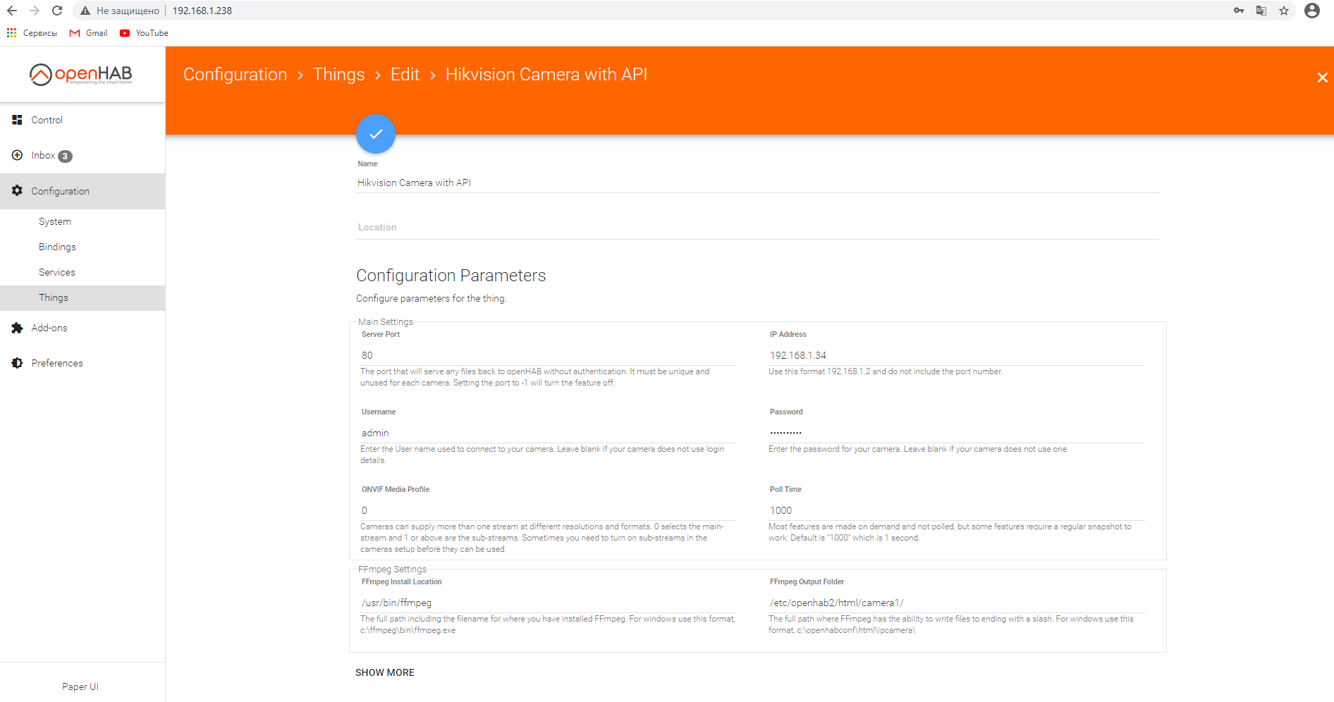

and here are the thing settings:
If I go to http://openhaburl:8001 I just get a blank screen.
I’ve tried a number of changes but can’t seem to get anything to work. Am I missing something dumb or does this not work? I have an Onvif camera that is working fine.
