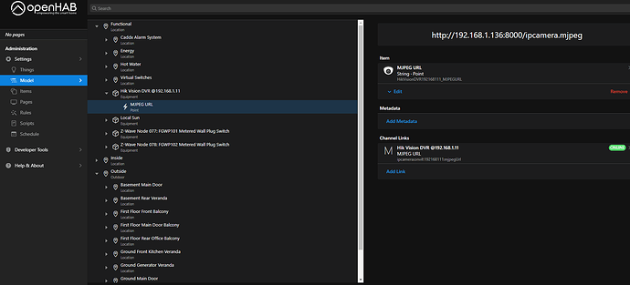

Hi all, I am on OH3 on my rasberry pi 4b.
I have 3 or 4 habpanel dashboards on tablets across the house and would like one to display the cameras from my hikvision nvr when the corresponding dashboard is selected
I have installed the binding.
The nvr appears online.
I tried using the string created by the channel to display but nothing coming through.
Q1 - does ffmpeg need to be installed;
Q2 - what is the best scenario cpu wise; I don’t need the cameras when I am not looking at the dash.
Thanks!

No but some features do require it. What URL were you wanting to display? Snapshots and autofps mjpeg streams do not need ffmpeg if your camera can supply a snapshot.
The lowest impact on your system would be the autofps.mjpeg since your cameras have motion detection in them. The ipcamera.mjpeg should also work if you setup the camera as per the docs and won’t need ffmpeg either. Just give them a try to see what U prefer.
hi @matt1 the url that the system is giving me is as
i am also repeating incase i wasnt clear that i am on an NVR (h.264) encoding. For now I want something that only looks at the cameras of the NVR (channel0?) and only when i look at the habpanel dashboard. I am pretty sure the nvr doesnt support mjpeg

You mention that your on a Hikvision NVR, please read the notes on how to setup these in the bindings documentation in the setup section. To learn more as to why it is not working you need to use DEBUG mode or TRACE, which how to do this is covered in the very top of the docs on what to do if you need help.
they are not compatible, and why it became a new major version number. This is due to how OH3 got rid of eclipse framework which should make it easier to move the project forward quicker. OH3 is a lot better.

I notice your using a mjpeg stream as the source, is that the only option? Can you use a h264 stream instead? There are a number of untested paths the binding can take and I probably have never tested a mjpeg stream getting split into snapshots as most cameras can create a snapshot. Does your camera have snapshot urls?
Is the double slash a typo mistake? It is interesting as the DEBUG output seems to indicate you have not supplied the snapshot url but the thing file shows you have. If it does not work, let me know and I can run some tests as it has been a while since I tested certain parts of the binding.

I really appreciate the sheer volume of your contribution here. I have done a lot of reading across the forum but there are parts which are little holes in my understanding which are keeping me from getting a full picture/next step.
To be more specific on my case.
HIKVISION NVR Hybrid version DS-7216HUHI-K2
Connected to Openhab (users/isapi etc) setup.
As far as my limited understanding is concerned since openhab doesnt have ffmpeg by default it isnt installed.
my DVR doesnt support mjpeg video.
When i test the image url provided by the channel of the binding i get an image back of the first of 16 cameras.
It is installed via the binding as an onvif (should it be hikvision api or something like that?)
what my use case is, is:
to be able to use your habpanel widget to access the screenshots of cameras and then get video back when clicked (this is what is does as i understand) - i have the widget installed but i dont know how to get the urls of other cameras beside the first one and certainly a video stream one - dont need amazing resolution but it would be nice. Ideally without heavy processor usage. the heavy processor usage isnt a major issue however if it only occurs during watching the video stream (i have an RPI4b 8gb) - it wont be the default habpanel just an alternate one. only one i accessed during an alarm incident - so it may have a increase but it will be for max 1 minutes
What i see from trace log (by the way how do you switch it off afterwards?)
ffmpeg errors nothing else as such. I guess this means it just isn’t installed.
I can also use this url http://192.168.1.11/ISAPI/Streaming/channels/202/picture to access camera 2 of the nvr but need to login first with the admin username and password. I guess this means that i can bypass the login/pass part by using the binding but I don’t know how to get the right url.
So how can i get access to all cameras via widget in video? do i need ffmpeg installed or no joy?
