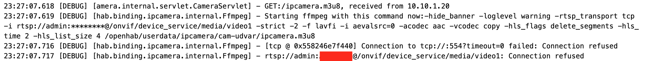

I also have ipcamera problem since OH3.2.
I upgraded from OH3.1 where HLS stream was working fine.
Now HLS URL gives 404 error.
If I turn on debug log for ipcam binding, I see that the ip is missing from the source URL in the ffmpeg command. Is it a bug maybe in this new version?
Regards,
Zsolt
