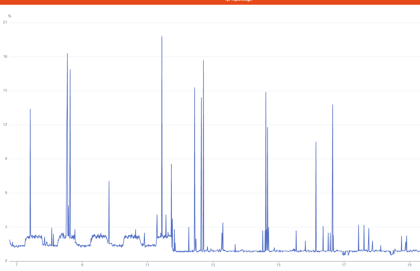

So I was not having any issues (reolink cameras), but wanted to report the new IP camera binding with breaking changes uses less CPU on my Rpi4. Here is a picture of before and after. A little hard to read, but the change is about the middle of the graph. The spikes are when video was triggered.
Thanks @matt1 for all your efforts. I think it is a very important OH binding.
Bob
