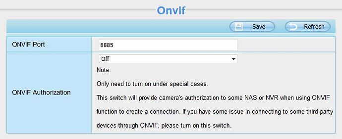

Is it possible for IpCamera binding to work with Foscam R2 camera and use PTZ functions?
That camera has these options (https://www.foscam.es/descarga/Foscam-IPCamera-CGI-User-Guide-AllPlatforms-2015.11.06.pdf) and ONVIF protocol.
I have tried to adjust all settings but cannot force OpenHAB to send PTZ commands to camera.
So far only picture in a frame works with options like below. No PTZ.
My setup is:
  • OpenHAB 2.5.0.M3 on RPi3 (openHABian)
  • IpCamera binding from 03-Aug-2019
  • Foscam R2 camera
During the startup in log (with TRACE log level) there is:

I was trying different options like ONVIF port and authorization:
Also cache and temp were cleaned and everything was restarted at least few times.
Maybe someone can help me with that issue. Especially @matt1’s help would be appreciated :slight_smile:

I suggest you test the camera out with the opensource program called ONVIF Device Manager, you need to use absolute movement controls to test what the binding tries to do. If it works in there then it will need a change to the ONVIF library that does the ptz functions.
Thanks @matt1 for replay.
