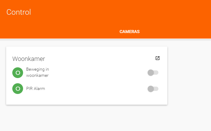

Switch Camera_Woonkamer_PIR “Beweging in woonkamer” {channel=“ipcamera:HIKVISION:Woonkamer:pirAlarm”}
paperUI

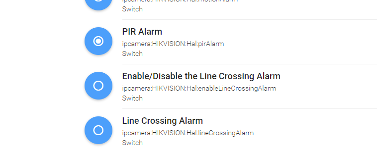

@matt1
where can i find the enable/disable PIR alarm?
Like you have for the Enable/Disable the Line Crossing Alarm?

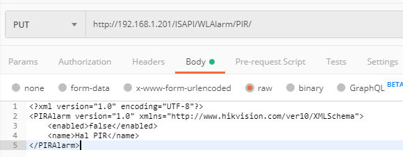

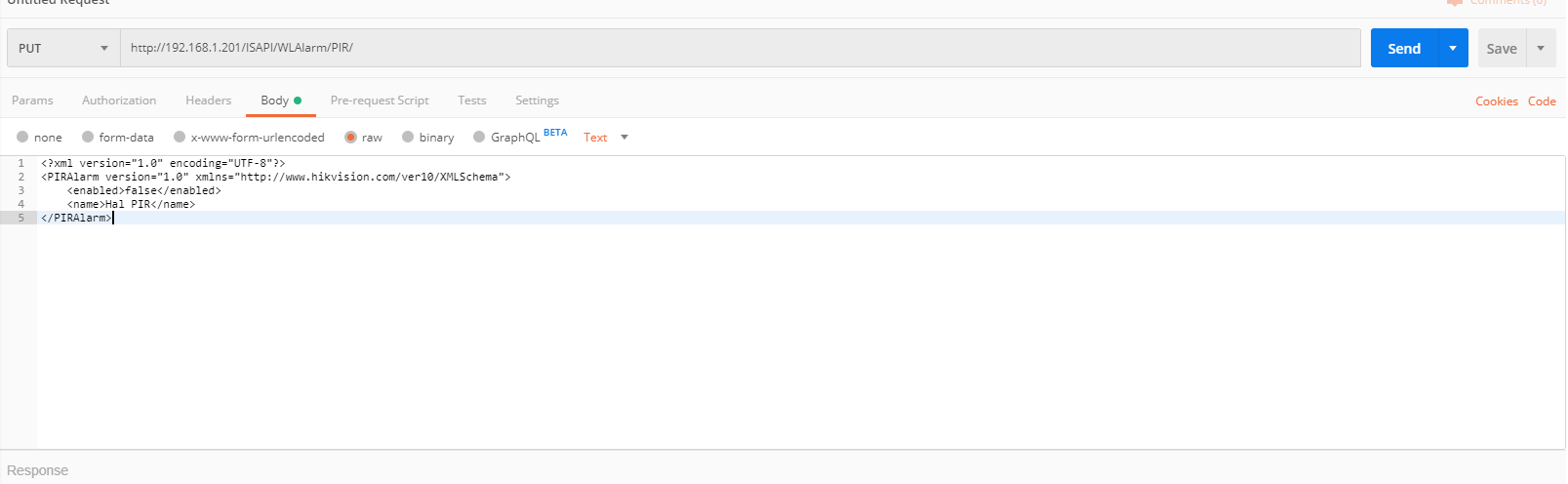

If i use PostMan i can modify the xml by passing a raw xml to the body

POSTMAN:
When you do a GET to http://[IPADDRESS_CAMERATHING]/ISAPI/WLAlarm/PIR
then you will get an xml with the current state of the PIR is enable or disabled
<?xml version="1.0" encoding="UTF-8"?>
<PIRAlarm version="1.0" xmlns="http://www.hikvision.com/ver10/XMLSchema">
    <enabled>false</enabled>
    <name>Hal PIR</name>
</PIRAlarm>
When you do a PUT in postman you have to send an xml format like in the picture above with
<enabled>false</enabled> or <enabled>true</enabled>
If it is sended you will get a return result also in an xml format
<ResponseStatus version="2.0" xmlns="http://www.hikvision.com/ver20/XMLSchema">
<requestURL>/ISAPI/WLAlarm/PIR</requestURL>
<statusCode>2</statusCode>
<statusString>Success</statusString>
</ResponseStatus>
So in openHAB we will need a Switch like this one:
