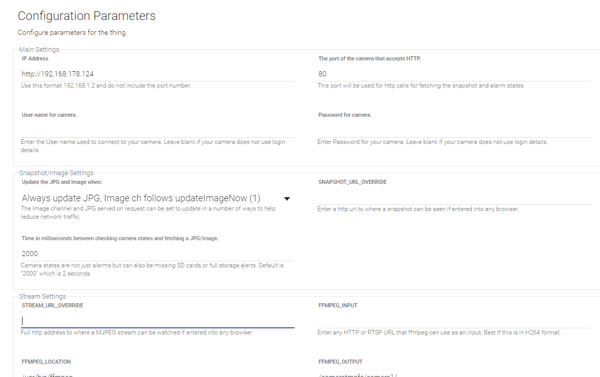

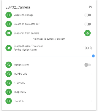

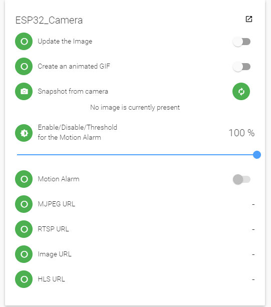

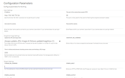

I have not clear what parameters I need to keep an ESP32 cam working.
I’d read the limitation, but for my pourpose it will be not a problem have 1 FPS.
I try to add a thing “HTTP only camera” and I enter the following parameters
But no resoult
I try several IP variant without success, like
http://192.168.178.124/capture
on the other hand if I put the URL on the browser the ESP cam module works as normal
I had no luck to find usefull information for these case looking at older post in these topic.
Thanks a lot for helping.
