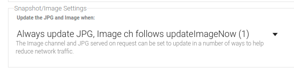

Update the image (Switch). It works, but only if I set the option (1) in Snapshot/image update to always. Then I can turn on/off the image update.. I believe this is not correct according to the text, the option (0) is said to update, only when the Switch is ON. (It doesnt).
Snapshot from camera - Works just fine. The image update every 2 seconds.

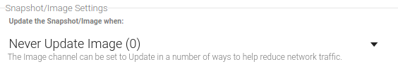

I updated to the new version today.
But i have a problem with the “auto-update” of the snapshot.
Although i configured following in paperUI:
It keeps updating (Same for all other settings)

Thanks for providing the log. I can see that the control never gets sent the COMMAND to go OFF. Not an expert on the expire binding, you may need to ask in a new thread but control can be sent a state update which moves the control without sending the COMMAND. The binding needs the command to turn it off and since it is not sent the updates still occur.
So not a bug as it would work as intended if you used a rule or moved the control manually. Hopefully it is simple to fix with using the expire binding in a slightly different way.
Now it’s working.
I removed the expire definition in the item file and created a rule for the item:
var Timer cam_hof_timer = null
rule "cam hof update off"
    Item cam_hof_update changed to ON
    if (cam_hof_timer !== null) cam_hof_timer.cancel()
    cam_hof_timer=createTimer(now.plusSeconds(1), [ |
            cam_hof_update.sendCommand(OFF)
And i changed the setting in the PaperUI to:
Thanks for the help :grinning:
