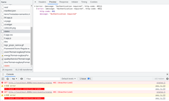

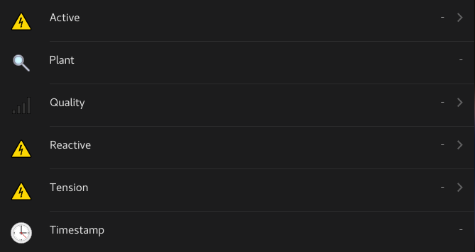

I have created some roles and I have added them so that they can see some specific layouts. This works for me, however, these layouts show data like temperatures and more and I can’t see those values. On the other hand, a user role user can see them. I have added to the code the visible one for the desired role.
Looking at the console it is returning me "{
“error”: {
“message”: “Access denied”,
“http-code”: 403
I don’t know if this has to do with what you said in the last paragraph about a token. I am new and I am not very clear about this.
Thanks in advance.
It tuns out that an openhab user needs to belong at least to either the administrator or the user role. Otherwise, the user will not be able to access any page contents, as the REST API will return this kind of unauthorised errors.
Then, you can add additional roles to a given user to manage access to the various pages depending on your needs at a role level, because one user can belong to several roles. Unfortunately, it seems there is no UI to perform this task as of version 3.1, neither through the web ui nor through the openhab karaf console.

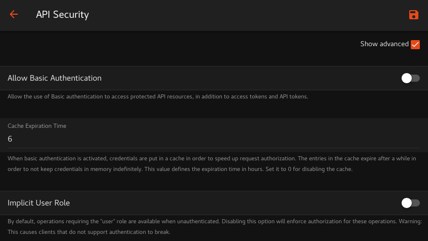

I wonder if it is necessary that the “implicit user role” option must be enabled to be able to see the screens.
Since disabling it has stopped working even for the administrator role and I get a 401 message as before. I do not understand anything.
On the other hand, I’m concerned that if I don’t disable this option, anyone can make GET / PUT … requests via API and get results.
I would like that API requests could not be made if credentials are not used but I also need to be able to see the data.
Any ideas?
The “implicit user” function, as described is needed for “clients” that are not able to do “authentification”… Which mainly means when something uses the rest api to acces data from openHAB.. If u do something like that you are for sure aware of what it means…
But there is a second thing, where it is needed for. If you e.g. access openHAB via your webbrowser without providing user credentials (namely log in), you will see the fields that are not restricted to special users or administrators by the visibleTo flag, but you will not see the data that should be displayed in the widgets, as the “anonymous user” without implicit user role is not considered a user and will not get data..
Now u have to chances to fix that:
Turn on implicit user role, but this will allow anybody from anywhere to see the data or in case of a switch even turn it on, if your firewall doesn’t restrict acces or someone did break through your router into your network.
Or you define exceptions for IP adress ranges that get the implicit user role even implicit user role is turned of in trusted networks section, what is the thing I suggest, if u have, need or want to access openHAB without providing credentials.
basically on security there are always two approaches..
The brave approach, allow everything that you do not necessarily need to prohibit and then start prohibiting, and see if things still work as you want (the approach I suggest, as long as your firewall is safe and u do neither portforward your OH to the internet nor use the cloud acces system).. Means turn on implicit user role and ignore trusted networks, till the very day you need to close things, then turn off implicit user and set your complete local network to trusted [coma seperated CIDR notation].
The fearful approach, turn off implicit user and not set trusted network, then unauthorized acces will never work.. And then only if unauthorized acces is need enter the exact IP adress of the device from which unauthorized acces with implicit user role is needed in the trusted networks section…
