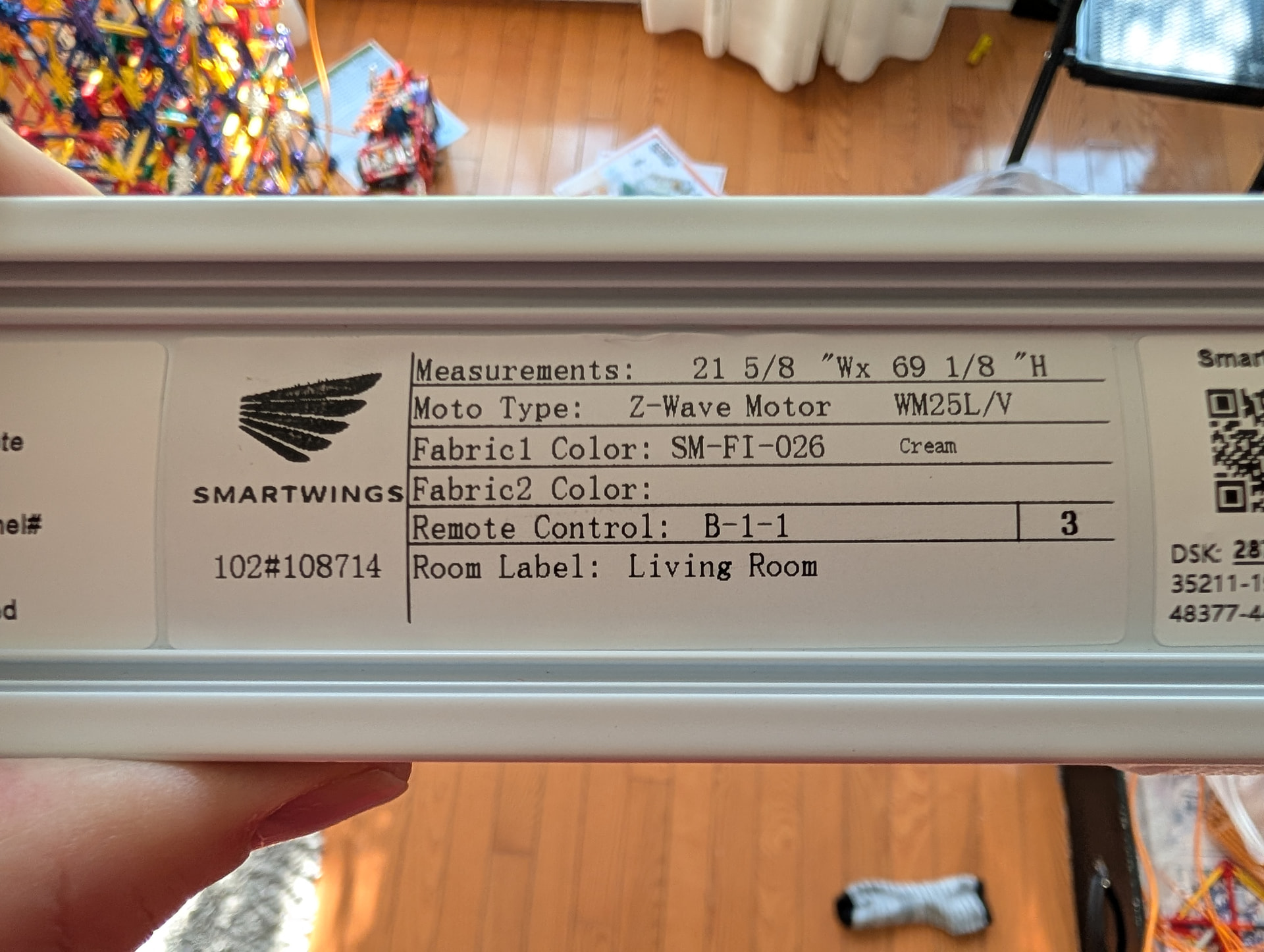

It’s a SmartWings blinds motor, model WM25L/V
It was good you posted the XML. Before this can be added to the ZWDB (by anyone) SmartWings needs to be added as a new manufacturer. Modify your ticket for write access to include asking for the new manufacturer SmartWings (0x046a) to be created.
