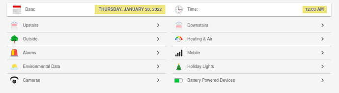

I’m testing various way to display the date and time in more readable formats. I was finally able to get it to display, I’m just wondering if there is a list of variables for Openhab 3. Here is a screenshot of what I am doing:

The only issue I am having is that the list shows the letter conversions in first letter upper-cased and the rest of the word lower-case. My screen showed it all upper-case. I must be missing something, but I don’t see anywhere to fix it.
Examples
'B' Locale-specific full month name , e.g. "January", "February".
