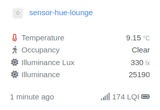

I am using zigbee2mqtt and Philips Hue motion sensor that has light sensor, temperature and motion and it works fine.
