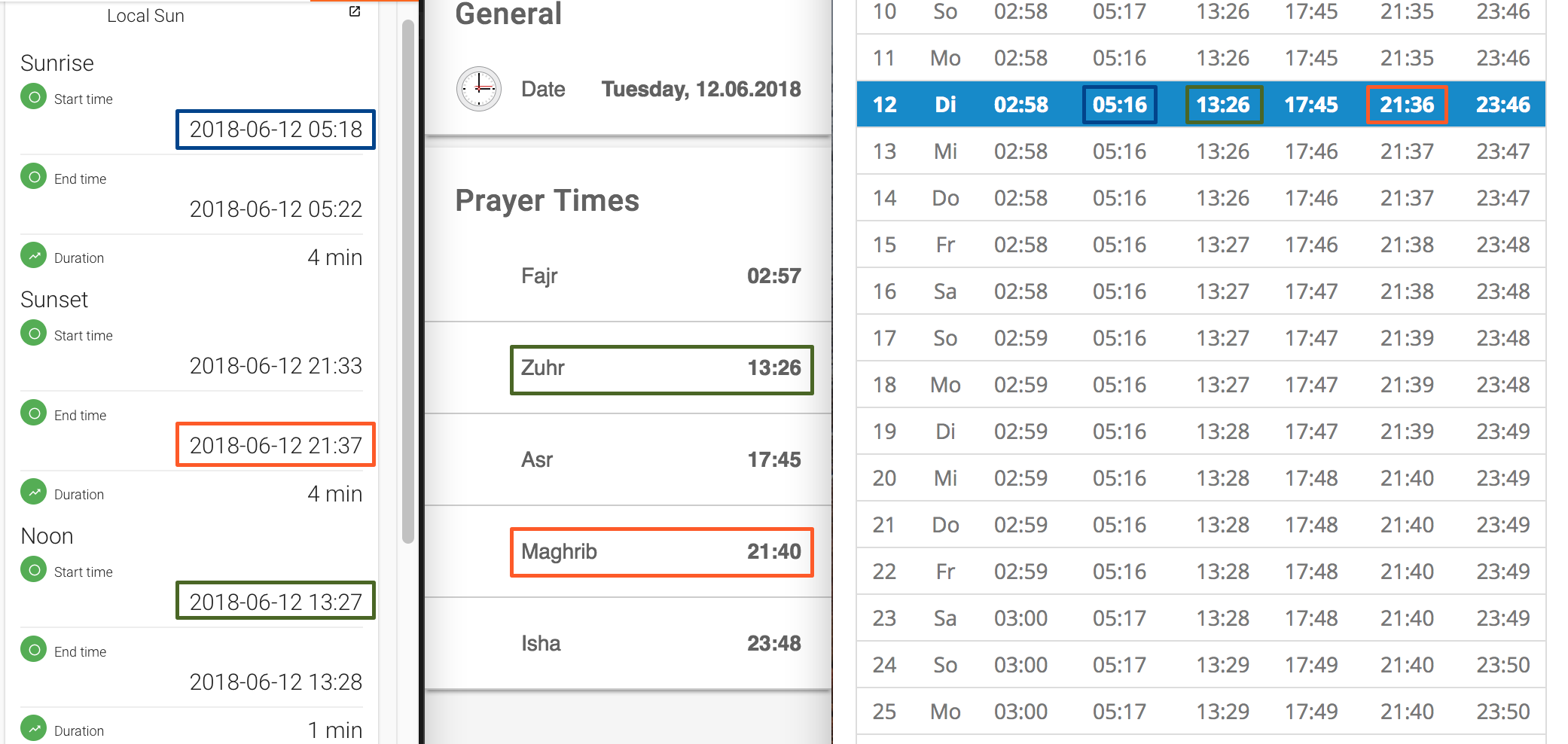

Some of these times could be obtained from the Astro binding. However Asr is not available in the Astro binding and it’s value depends according to different Islamic schools of thought.
The times of Fajr and Isha are also not available reliably in the Astro binding at high latitudes and special calculations are required to obtain these times.
At the required times a call to prayer is performed. This is the call from the Muezzin at the top of the minaret. However this is now usually done with speakers!!
The times for the day are calculated using a python script every day after midnight.
This python script is from http://praytimes.org/
Every minute openHAB will check if one of these times is reached and perform different actions depending on your choice.

Hm, fun task indeed. But it seems that the astro binding has some kind of “bug” when it comes to the event times. I might be wrong, but have a look at the following:
The calculation of noon (green frames) is off by a minute in the astro binding compared to the results of the playtimes.py script as well as some randomly picked website for calculation of the same. Well, even the results for sunrise (blue frames) and sunset (red frames) differ between all three calculations.
The calculation method in the astro binding seems to be derived from http://www.suncalc.net as stated in the code:
https://github.com/eclipse/smarthome/blob/master/extensions/binding/org.eclipse.smarthome.binding.astro/src/main/java/org/eclipse/smarthome/binding/astro/internal/calc/SunCalc.java
But even some results from this website are off by a minute compared with the astro binding:
Interesting survey of the results. It certainly looks like a rounding error in the Astro binding or something like that.
It might be worth going an issue on the astro binding. For something like lighting it probably doesn’t matter but for some uses that minute could be important.
In this case, the minute IS important.
I live in Watford approx 20 miles NE of London. The London central mosque hours are of by a minute or two depending on the time of the year.
But I get what you are saying. It should only depend on latitude and longitude. There are many website that provide sunrise and sunset and they are all within a minute or two of each other.
I am not saying that the python script gives the most accurate answer but I have stood outsite at sunset several time and the sunset occurred within that minute.

However, as I told you that pray times are not accurate (especially maghreb, around 3 minutes, and maybe you know maghreb time is important for ramadan).
Also maybe it is better to check if the script brought the current date (day), if no then call the script again (this is to resolve the case if the system shut down at the specified time of getting pray times)
Maghrib is accurate for me. Again you can adjust the times in the settings.
Good idea about the day, I’ll have a look.
