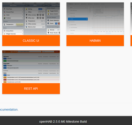

First, there is no “Milestone2.5” The tatest testing release is “2.5 Milestone 6”.
Try rebooting or restarting openHAB. openHAB thinks another process is using that URL.
That is documented in the upgrade warnings. In Milestone 2, REST Docs moved from misc to ui.
  Warning:  REST Docs: This add-on is now part of the UIs. When installing it using textual configuration, update 'services/addons.cfg' by removing 'restdocs' from 'misc' and add it to 'ui' instead.
I have already restart the OH and clean up the cache, I think /start/index change or ar duplicated inside of Karaf folder, but I’m not sure where it’s storage and how to change it.
Another question, how to check the milestone it self?

You should not have 2 dashboards. I believe the SNAPSHOt one needs to be uninstalled.
@mvo
It seems that openhab-ui-dashboard is installed twice.

 286 | Active | 80 | 2.5.0.M5 | openHAB UI :: Bundles :: Dashboard UI
So it seems you have a mixture of 2.5.0.M5 and 2.5.0-SNAPSHOT.
Please do:
bundle:uninstall 286
feature:install openhab-ui-dashboard
I’m on 2.5.0-SNAPSHOT
Build #1774
