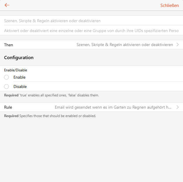

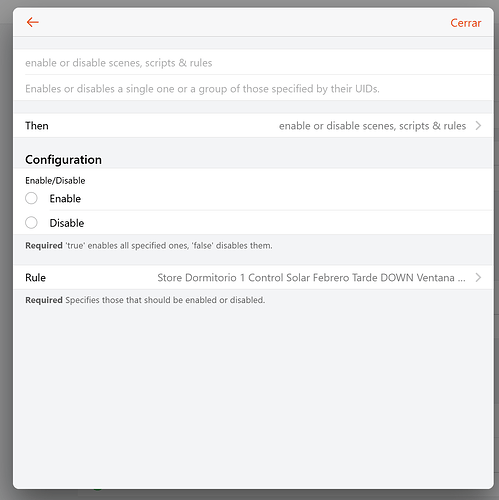

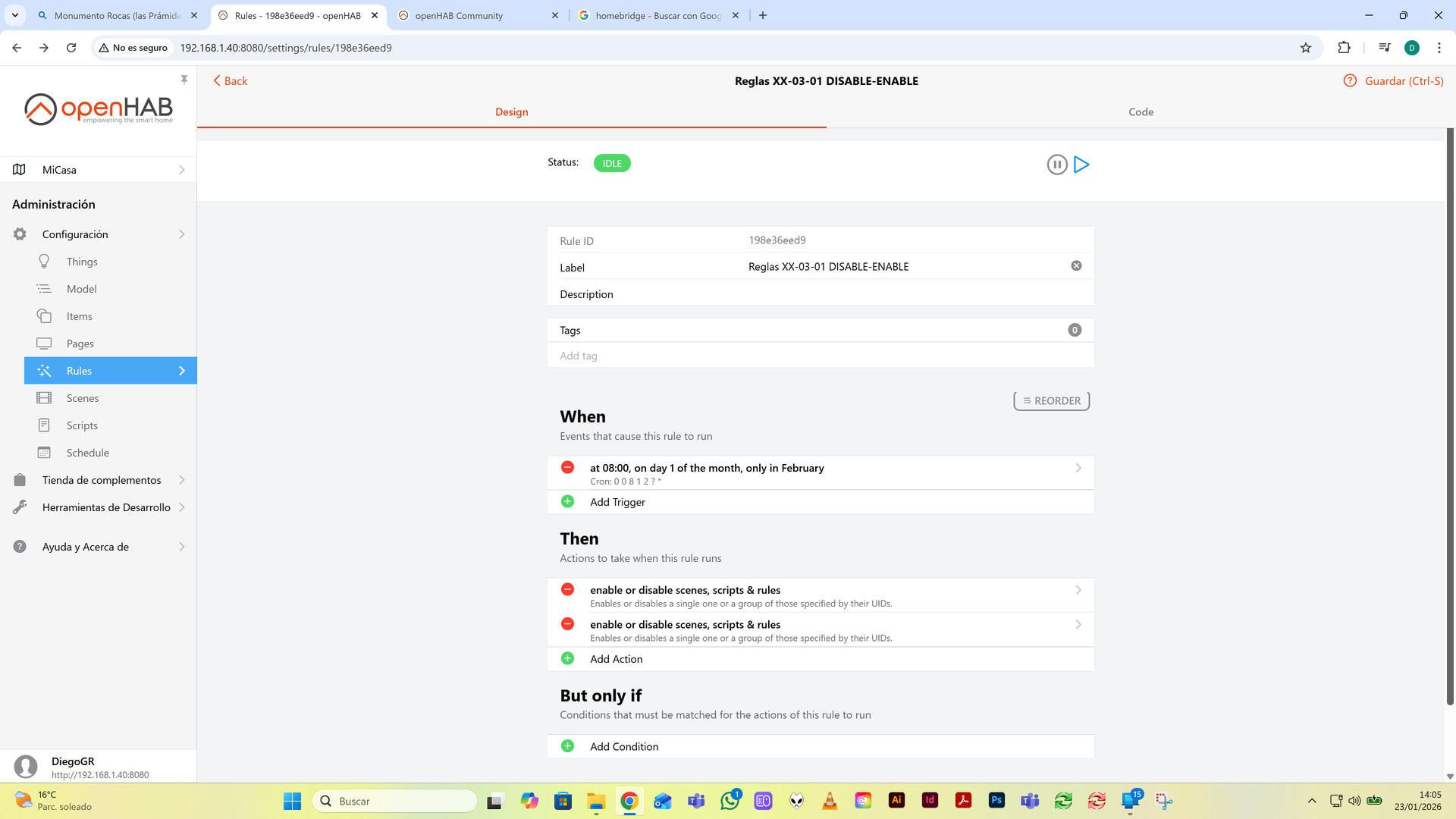

I have noticed about a malfunction in rule engine at main UI:
when a enable/disable scenes/script/rules is selected as an action in a rule design
There are no marks either on Enable or Disable options, so it is not easy to see the current configuration of the rule unless you show YAML code:

Action id 3 shows enable as TRUE, but it is not shown in the previous selection box. I have noticed that this happens in all the OH 5 versions, but not in OH4.

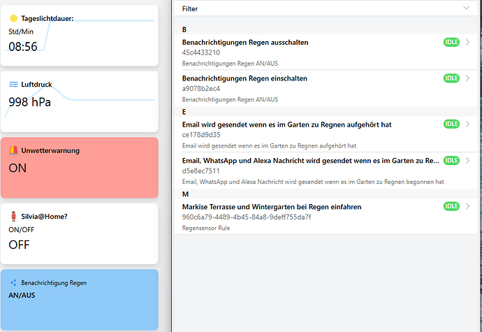

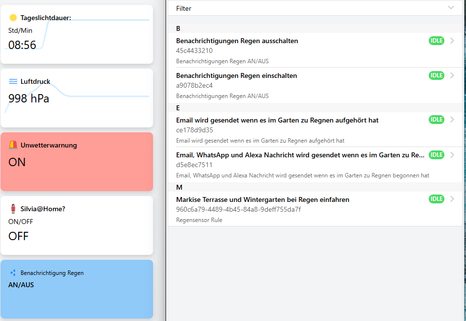

I can confirm this:
But the rules itself will be actived or deactived when I trigger them e.g. via a cell:
disabeld:
enabled:
