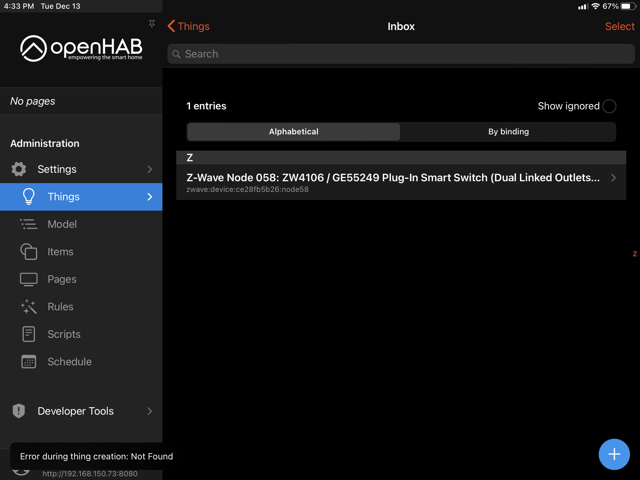

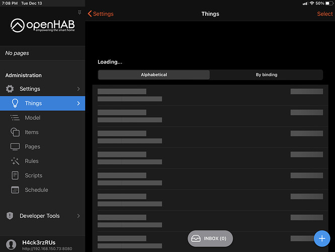

I’ve recently had success adding other z-wave outlet switches to my system…largely uneventful…this latest one has stumped me. When I initially scanned, the system discovered quickly, but when I added it, the things list apparently corrupted. No things were listed and several now in the inbox. I pulled up the Things JSON and didn’t see an obvious corruption. I restored from backup. Everything back to normal.
Now, after the restore, I have the device showing in the inbox (full name / description), but when I go to add it, I get the error “Not Found.”
I rescanned, and now it shows with a much more abbreviated name. Go to add it…same error.
All of this is being done with the outlet plugged in within two feet of the controller (all at my equipment rack).
What’s going on here? I can’t find much info about “Error during thing creation: Not Found”

Nortek HUSBZB-1
enbrighten 55249 (Discovered as ZW4106 / GE55249… GE branded on device enclosure)

I excluded it. New scan discovers it as a new node (was 58, now 59). I add it, get past the Not Found error with a response that the device was approved. BANG! Things are hosed again.
So, I pull up /var/lib/openhab/jsondb/org.openhab.core.thing.Thing.json and node59 is there with a thingTypeUID that matches what I’d expect for this device model. I haven’t connected every dot, but my take is that when this definition gets into the Things DB, it corrupts. That’s not a z-wave issue, but if this is a meaningful observation, it suggests something fairly specific to this device’s default Thing definition.

Thanks very much, Bob. I feel like we’re close, but I’m missing something (probably) trivial.
I went into the discovery screen and removed the pending results. I rescanned, and when my result came back, I attempted to add. This time, it’s no longer hosing the system (that’s a great improvement, of course). It’s also failing to add, though. Here’s what the log shows:
Thoughts on next steps to push this over the edge? Thanks again!
Since node 59 was from before, it was not excluded (using the controller UI to exclude). It is still showing the duplicate channel so has a stale version.
Ah, got it! The term “exclude” didn’t immediately click properly with me. Sorry.
So, I got it excluded at the controller. It’s now discovered as node60. Still getting the same error, though. Log says unable to be approved: Duplicate channels zwave:device:[controllerID]:node60:scene_number
Must still be missing some nuance. Forgive any ignorance on my part. Really appreciate the help. We’re close!

Interesting side observation…my Things list did eventually go bad (like it was more promptly before), seemingly without doing anything further to aggravate. So, I’ve restored my backup. Current state appears to be stable, and I’ve uninstalled & reinstalled the zwave binding from the openHAB distribution.
