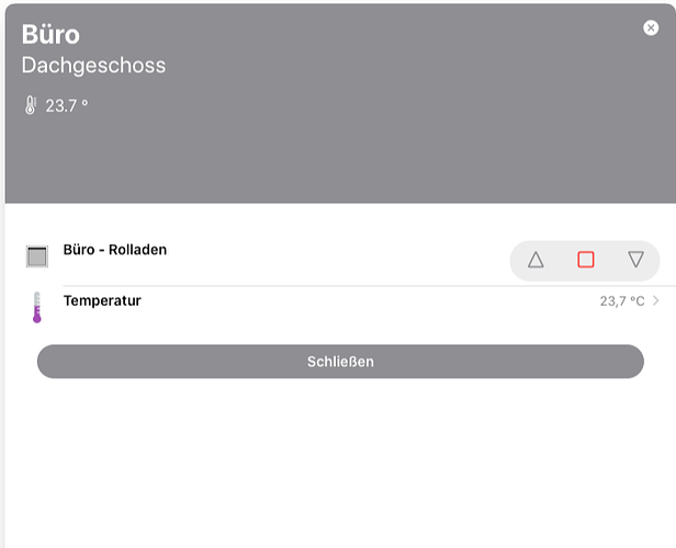

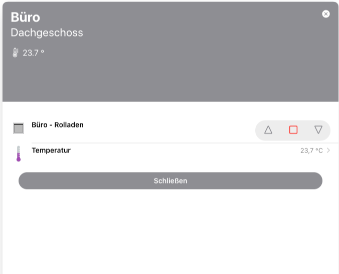

I’m trying to find my way through the new OH3 interface. I came to the point where I didn’t really know how to correctly name the item labels to get an intuitive way of using the default home screen in OH3.
E.g. I got a temperature item in the office. The item is labeled Temperatur. This makes sense for the Locations tab but it doesn’t make sense for the properties tab, which groups all the semantically tagged temperature items together. In this screen I would have a ton of Temperatur items only differentiated by the item name. (which has a namespaced name not really useful for the average joe user)
Is there a solution for that problem?

You need to make your Item name work in both places which will probably mean adding the location to the Item name. Also realize that you’ll need to select from that list of all the Temperatur labeled Items in other places too (developer sideboard, rules, etc.). You’ll need a way to distinguish between them there too.
This is true. But from a UX standpoint this is a bad solution. There should be a possibility to add two labels. As you can see above when I’m inside a room I don’t want the room to be mentioned again on the item name.

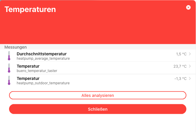

I don’t argue against what you’ve done but there are a bunch of other places where the label is used that become pretty unusable when non-unique labels are used.
  • Settings → Items which doesn’t use the model at all
  • the developer sidebar which also doesn’t use the model at all
  • Items not part of the model (though those probably already will have unique labels)
  • Manually linking a Channel to an existing Item
  • Sitemaps using the Group element (though if one is using that they probably are not using the model in the first place)
  • Selecting Items for properties on custom UI widgets and rule templates
If you have five iItems all with a “temperature” label, in some of theses cases it will be impossible to tell one item from another essentially making that feature unusable.
This problem s far greater than just the Overview pages and I’m hesitant to endorse something that potentially renders so many parts of MainUI unusable.
Sorry to contradict but in all these administration pages, the item label is either displayed above the Item name, which is by definition unique, or displayed in a model tree, which provides context and disambiguation. Maybe this was not the case in previous releases (I remember having that issue) but in 3.2 it is, I just checked. I think it is good practice to have items names that are meaningful, given that it it’s what used to perform all advanced task and when you have installation with a significant number of items its impossible to manage otherwise.

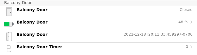

I tend to agree more with Rich on this one. Redundant item labels within an equipment group really offer no impediment to clarity at all, but redundant item labels across a category become unusable very quickly. Here’s just one example:
No user quickly glancing at this list is going to confuse the battery level of the sensor with the open status of the door regardless of what the label text says. And now, in my house door widget, which is automatically populated by semantic tags, I can see this:
which is, of course, clearer than if all the items where just labeled “status” and also, in my opinion, cleaner than if all the items had a label of “status” with the equipment appended to them because at that point the “status” is extraneous clutter.

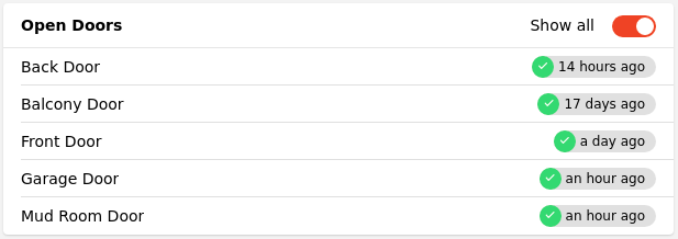

  • As just shown above, I have numerous custom widgets populated based entirely on semantic tags. Rich has published many such widgets to the new marketplace for beginning users to just install and start using right away adding to the out of the box utility of the model.
