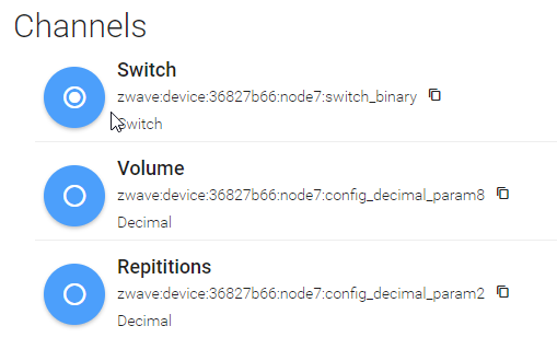

I just included the Aeotec doorbell (gen5) on my network. I configured its Switch channel, then I see this:
As you can see, the other 2 channels (Volume and Repititions [sic]) are of type “Decimal”.

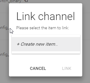

When I try to add a new Item to link to the Volume channel, I get the following prompt, which seems like it’s working:

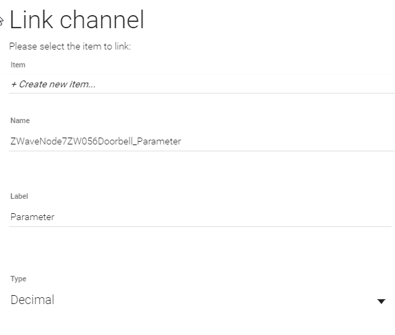

but when I click “Link” I see the following message in my logs:
[WARN ] [thome.io.rest.core.item.ItemResource] - Received HTTP PUT request at 'items/ZWaveNode7ZW056Doorbell_Parameter' with an invalid item type 'Decimal'.
This is just a warning, but the new Item is not created as a result. There were no other Types available to choose from in the previous drop-down. Decimal is the only one available.

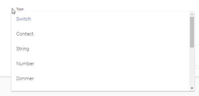

If I try to create a new Item manually, “Decimal” is not presented as an option in the list of Types:
(yes, I can scroll down, but “Decimal” isn’t down there).

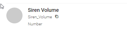

I did:
but when I try to link it to the Decimal channel:
It doesn’t show up, since only a Decimal Item would show up.
OK, I’m going to guess that the database entry for this Item is messed up. At a minimum, the Repetitions needs to be corrected, and seeing that error points at other errors being possible.
This is a link to the doorbell:
http://www.cd-jackson.com/index.php/zwave/zwave-device-database/zwave-device-list/devicesummary/263
I’m really no expert here on what could be wrong or how to fix it though. @chris, when you get back can you take a look?
